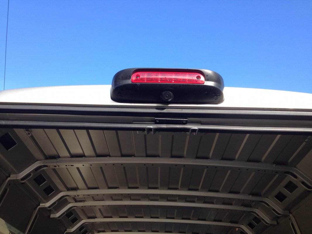

Thats better back on the laptop.
The vans colour is a very light Gold colour and in Metallic which is one of the many upgrades we have chosen.
Here is a list of the other upgrades......
Cruise Control / Speed Limiter
Reversing Camera linked to central radio system screen
Satellite Navigation
Bluetooth Radio
Cab Air Con
Uprated Alternator 180A
Reinforced Battery
Engine under-Tray Protection
Front and Rear Mudflaps
Uprated Tyres 16" Four Season
Alloys
LED day running lights
Rear Suspension Upgrade
So the fun begins. I say fun but its a bit daunting As Bob and Janie say knowing i have to start and cut, some big holes in the vans roof and sidewalls :Eeek:
