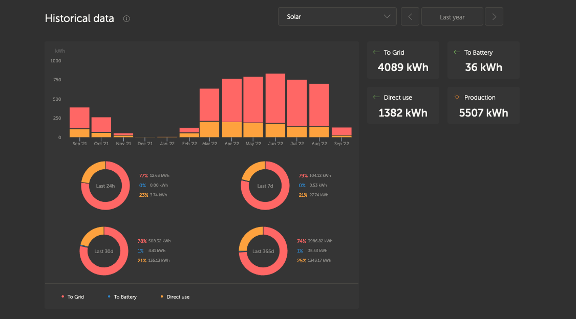

From our victron web, we have 20 panels about 5KW, we are 59 degrees north (about Orkney Islands)
