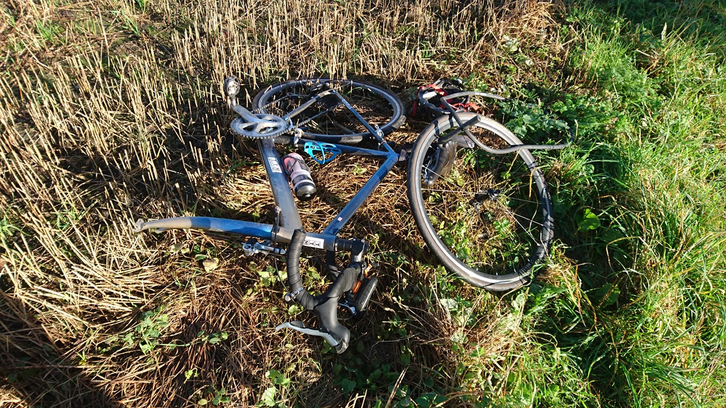

Got a puncture after about 5 miles today, first for over a year. Swapped the innertube for my spare and off I went again. A mile later the wheel was flat again. I found a small piece of glass stuck in the outside of the tyre. It was being pushed through while I rode the bike hence me not feeling it when I changed the first innertube. Fortunately I had a puncture repair kit so stuck a patch on both innertubes, fitted one and off I went. No further problems but headed home. So only 10 miles today......
