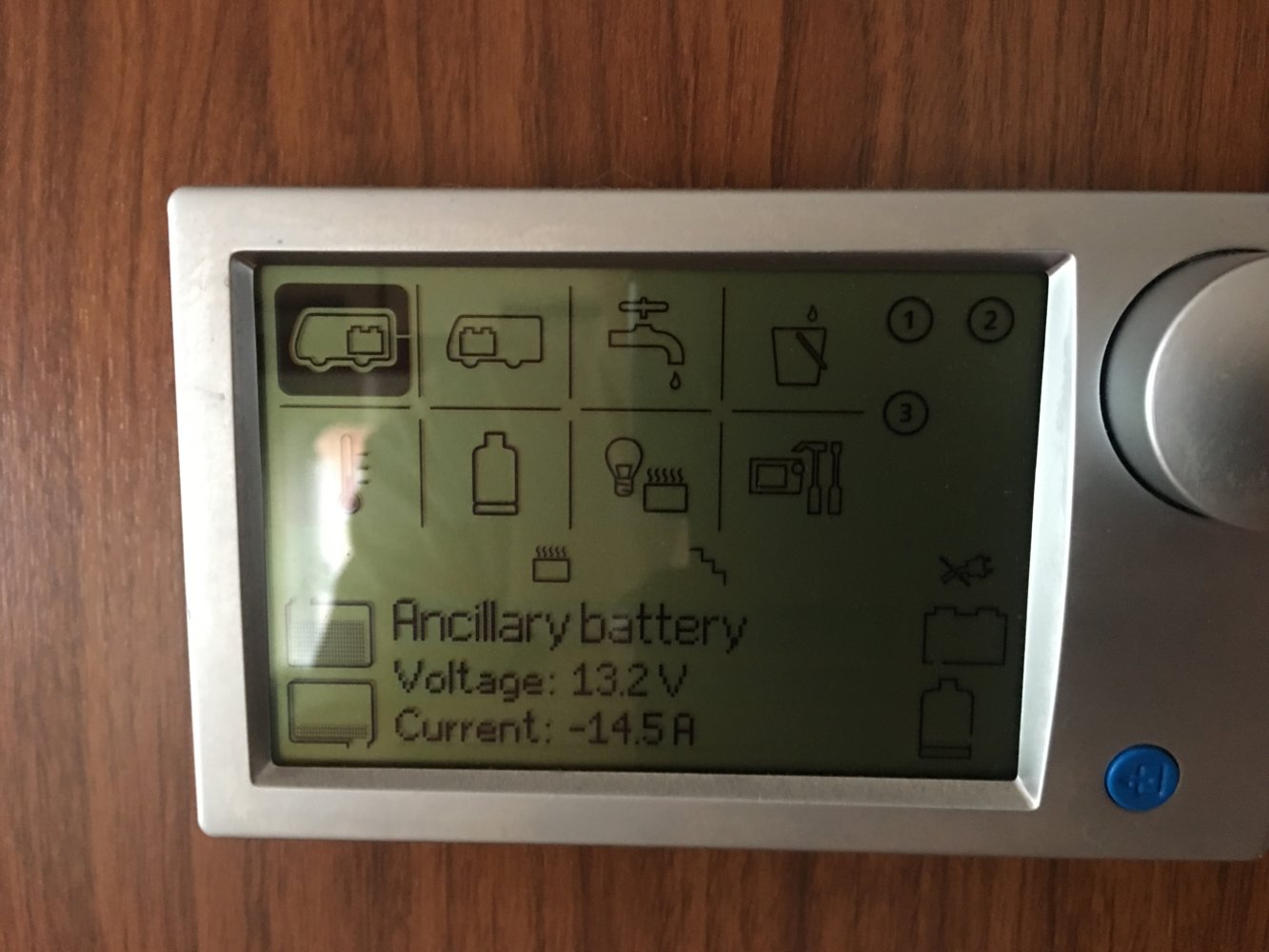

I have discovered a potentially disastrous option if 2 or 4 is used
I travelled to Alde today for service tomorrow
On arrival I manually swapped the power source to 12V as if I was at a garage, then spoiled my own test by plugging in to hook up :whistle:
So unplugged and did same again, I can firstly confirm that set that way mine does not attempt to revert back to gas after 15 minutes
However what I did spot was that it was taking power from the leisure battery not the cab battery
At a rate of 14A, I left it set this way for half an hour without any alarms but with rapidly falling battery level
Hence my concern, firstly I didn’t expect it to draw from the hab batteries at all, but if you forgot to swap back then arrived later off grid it is likely that before it went dark you would have no power left
I want to find a safe way to continue to refuel safely and think the standby option is the safest
I have on at least one occasion heard the gas cut in as I got back from paying, I think after LPG and diesel, filling and paying time can easily pass the 15 minute margin
Half an hour later, at least I know my batteries are half decent
I don't quite follow what you mean. However if the fridge is set to 12V, the Electroblock will switch to cab battery (ie alternator) when the engine is running, and back to the hab battery when the engine stops.
I was also confused and surprised that Hymer allow the fridge to be switched manually to 12V and draws from hab batteries when ignition off
Our first Hymer (2008) if no mains, gas, or engine running it would switch to hab batteries when set on AES (my mate found out the hard way). Easy fix pull the fuse marked AES on the EBL then it works as expected.
Current Hymer (2017) will only run from hab batteries for 15-20 min in the same situation but will run off the hab batteies continuously if you select 12 v manually, which is good as it gives the user the choice.
