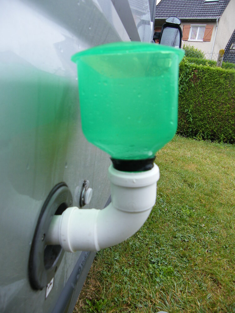

We have a domestic waste pipe elbow with a piece of pipe sticking out the end which slots into the filler then in top of this we pop a funnel, this means either of us can put water in without needing the other to hold the 'adaptor'. We also have 2 x 5L slimline carriers, one for each arm as it makes carrying them back to the MH when full much easier, they have small plugs at the top opposite the main outlet which allows air in whilst we pour so they don't gargle; we also have a large collapsible plastic one but don't use it much as it's bit of a s*d to try to pour from as it's like trying to grapple with a very large piece of jelly!
View attachment 419086 View attachment 419087
