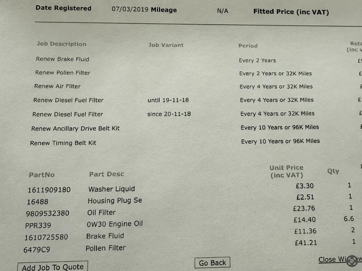

Here is the Peugeot version, for various items, for reference
From this I read that Peugeot are saying that the belt is good for ten years life span which I would agree with. I changed mine at 7 years, 22k miles, and the belt was in excellent condition. I also fitted a new water pump and it was as new.
For any one who is concerned about the water pump failing it is built very well and not like any pump I've seen in terms of robustness, I will not be changing mine ever again and would be happy to refit the one I removed.
Peugeot have kept the mileage as 96k though so are saying the same as fiat with respect to wear of the belt.

Now, it’s a bit embarrassing admitting this since I’m an engineer, but here goes…
I knew Peugeot, Citroen and Fiat cabs used for Motorhomes are all assembled on the same production line and I naively assumed there were only cosmetic differences to differentiate between them.
When I took my Peugeot Boxer based Motorhome for its MOT recently at a Peugeot main dealer I inquired about a price for changing the belt and was told it was not needed until 10 years or 96k miles.
I did some digging and discovered that, contrary to what I thought, Peugeot put their own engines in Boxers, hence the difference from Fiat’s recommendations.
Now I may be the only person on this forum who did not realise this, as I have since discovered other threads that mention this, but I’d never come across them before.
I am well aware of the dangers of a belt failing, and I will probably change mine before 10 years anyway. Everyone will have their opinion, but that is not really what this thread is intended for.
It’s just in case you have a Boxer-based unit and didn’t know. I suspect Citroen-based units will be the same.
Edit: mine is a 2018 build. Later or earlier models may be different!
