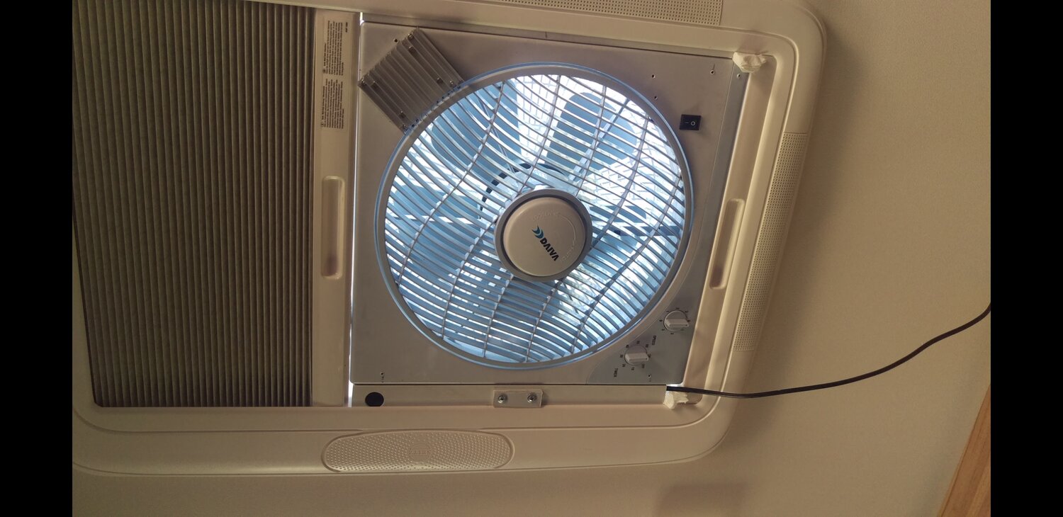

Look for a square fan that fits in your roof. I modified one by cutting the feet off and making it lock into the skylight and it is great at night bringing lots of cooler night air in.

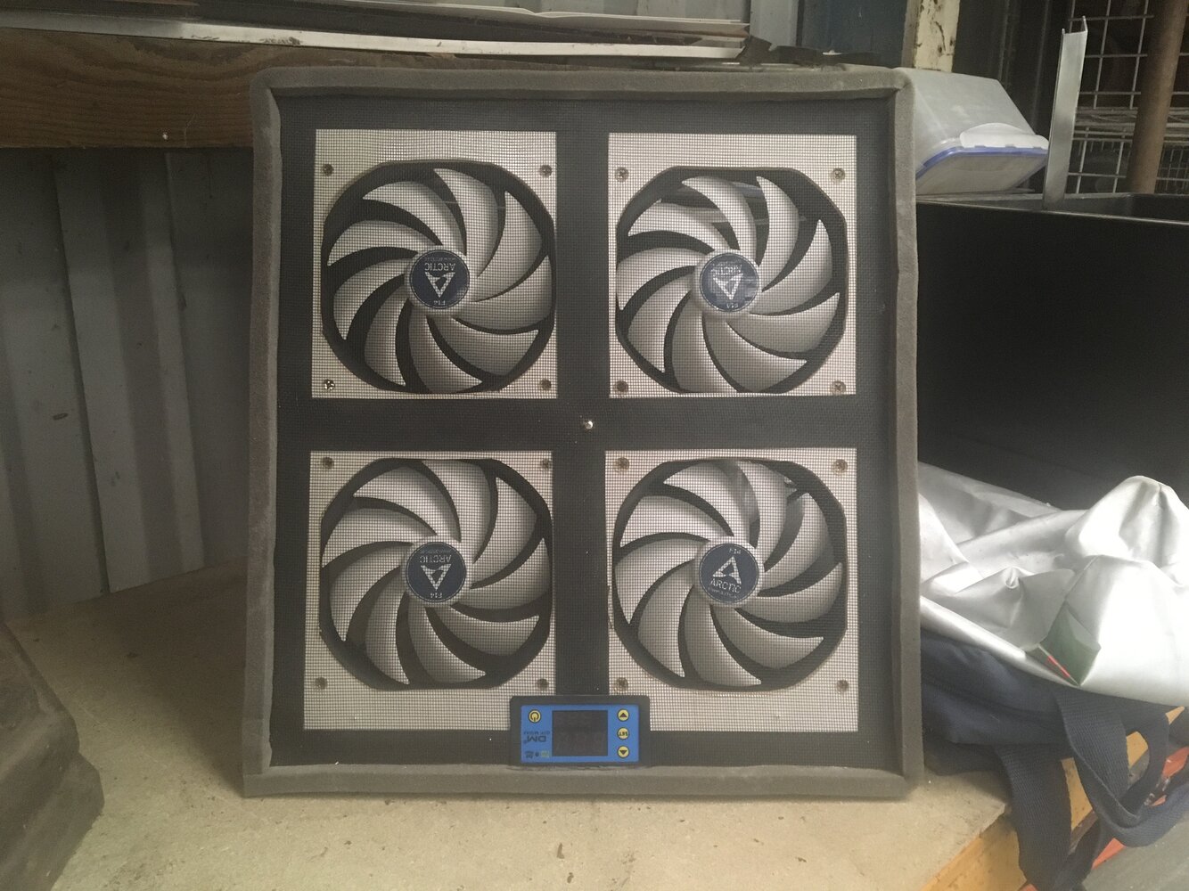

I made a 12v one to have on all night, uses less than 1 amp on low...
It's 4 computer fans, PWM speed control, mozzie guards and thermostat that switches it off if it gets cold during the night 👍

If you run all 4 you can leave out the mozzie guards, none come in and even if they did the little fast blades will kill them 👍
it’s thermostatically controlled (3 deg differential) so will switch off as the night cools
I didn’t bother with speed control because it was thermostatically controlled (probes in the centre)
that’s why I fitted mossie mesh 🥺
