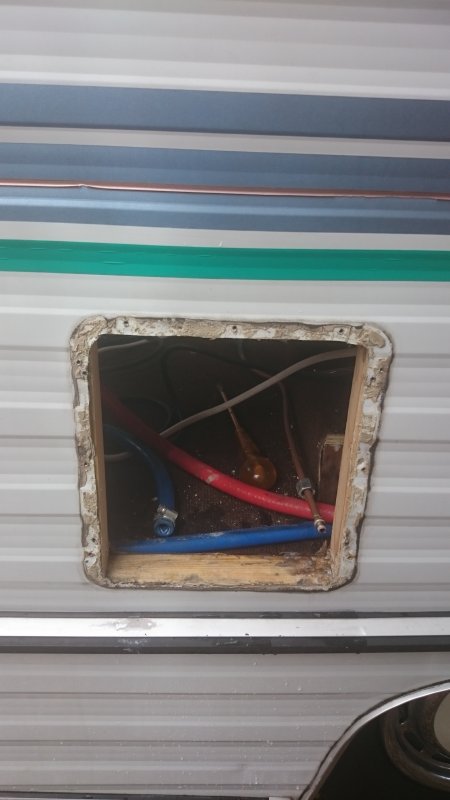

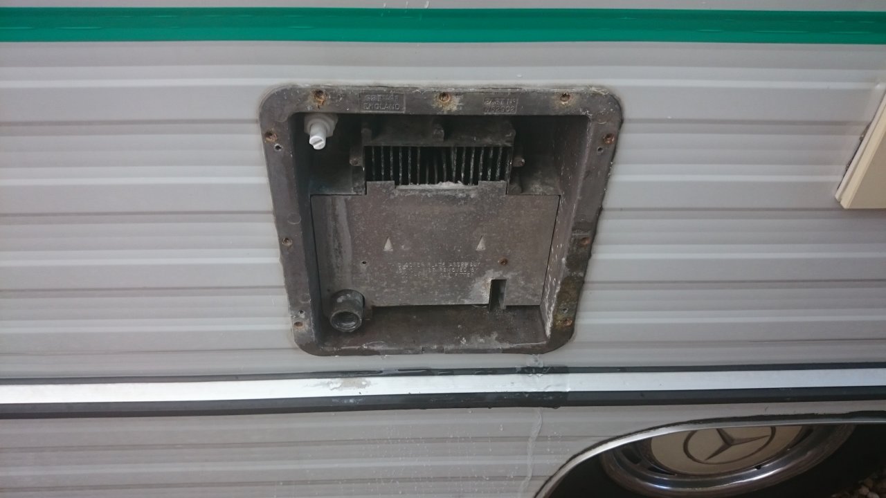

Back on track now with a replacement boiler. Unfortunately The Carver 2 boiler had 2 leaks, this may have been down to frost damage, this in turn also damaged the Burner Module. So out with the old and in with the new!
The boiler is located under the right hand side sofa
Burner outlet with cover removed

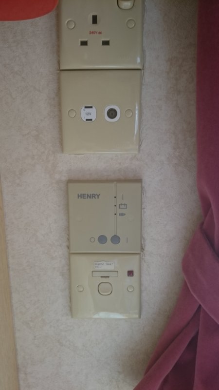

The Carver 2 controller has to be replaced with the new replacement Henry controller as the two arnt compatable between them

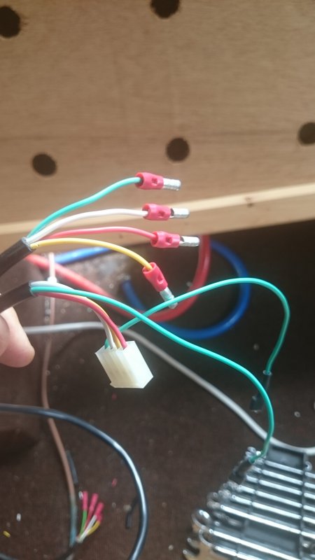

As the 4 pin connector was damaged at the boiler end, and the loom couldnt be changed due to the location of the controller, a joint needed to be made. I used bullet crimps and sockets to enable ease of removal, and the new Henry boilers come with a 3 pin kettle style lead, so a 20amp joint box was utilised to keep everything neat and tidy.
