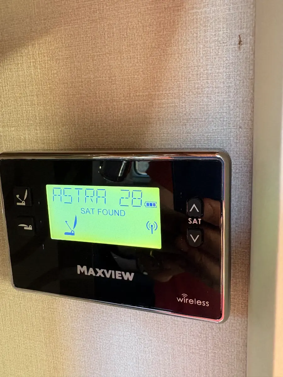

If just bought a used motorhome with a maxview seeker wireless satellite setup on connected to an Avtex tv.
The dish has clear view of sky, no obstruction at all.
It’s locked onto 28 but on wireless bit it says no satellite found.
Any suggestions Lee Rasberry

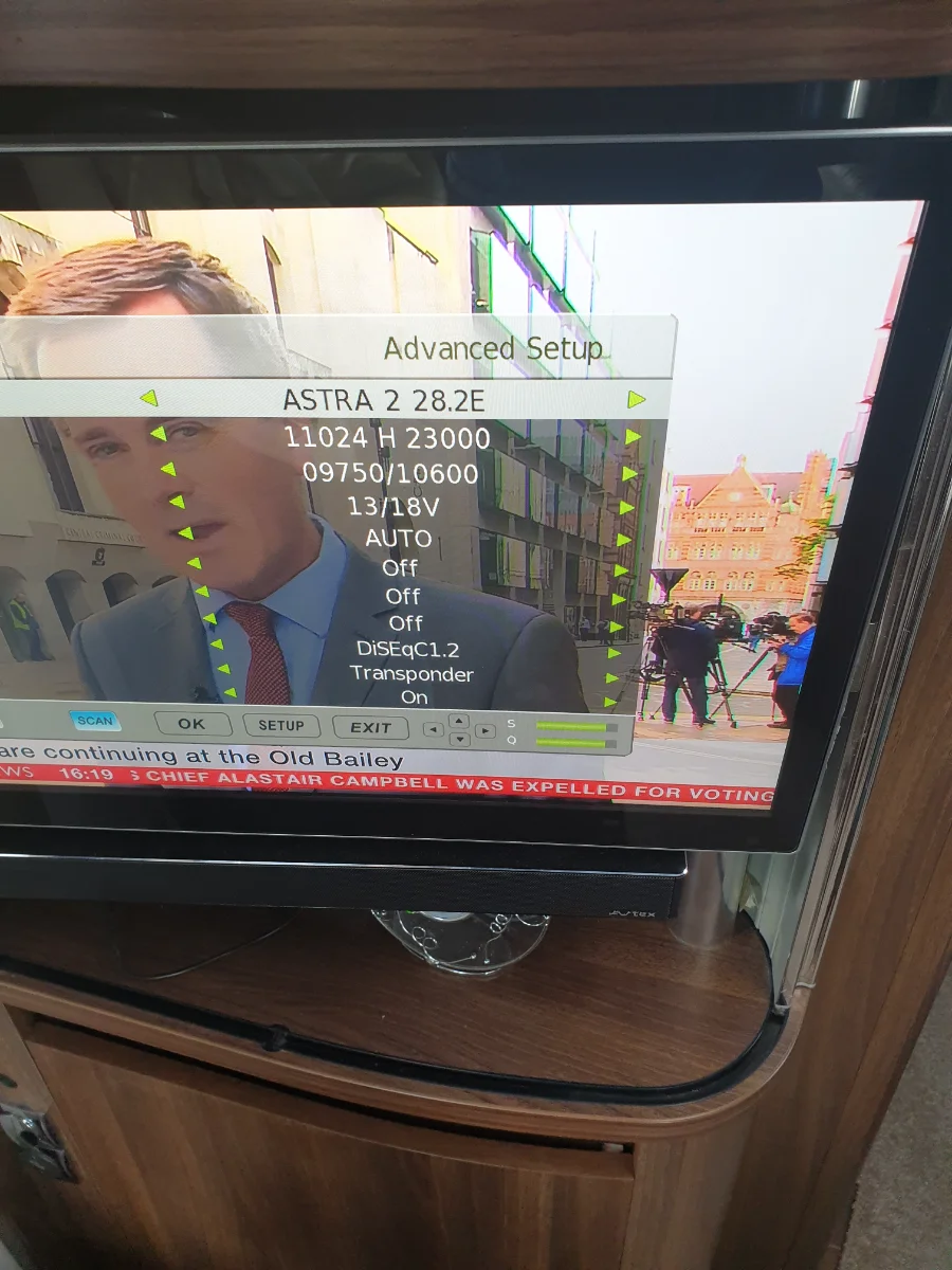

In the satellite menue make sure you have 2 green bars in the bottom right hand corner

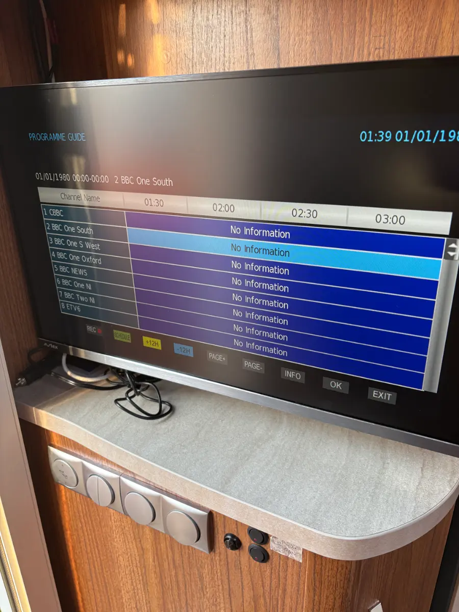

I’m going to try my Freesat box and by tv next, see what happens with that

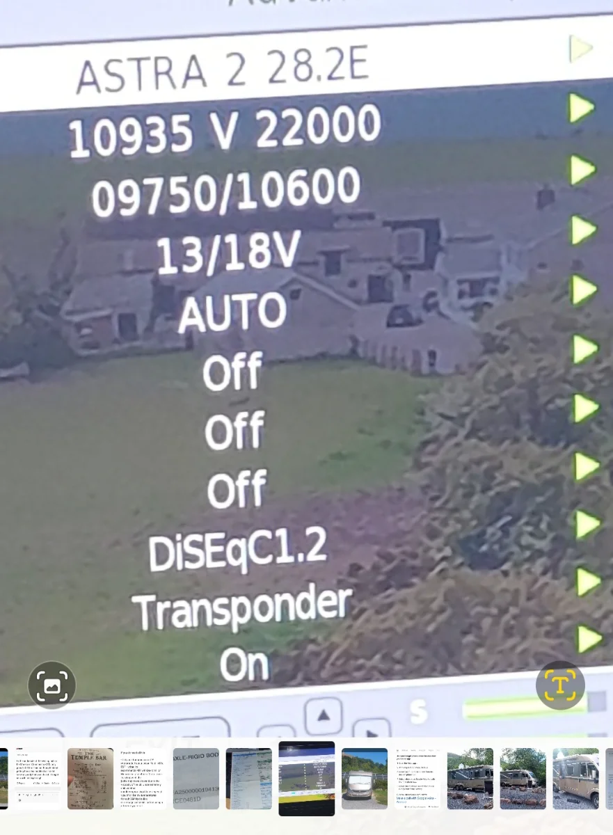

You need to have 2 blue bars to receive tv channels on the second line down try clicking on the right arrow until you get 2 blue lines then scroll down to transponder to search

My plan is to use my Finlux tv and Freesat box anyway and that’s what I plan to try later. Cheers
To reset the tv back tp factory settings select satellite then enter either 2580 or 0852 can't remember if you hold down the button on the remote that selects tv
After you have done a factory reset check to see if you have the 2 green or in your case blue bars on the bottom right of the settings menu you need to to be on the right settings to able to search the transponder
Later this afternoon I will go down the storage where my van is and il take a photo of my settings I'm sure they are the same as the photos I have put up they were taken a couple of years ago.

Thanks for all the suggestions , have done what I intended to do anyway and used my Humax Freesat box and it came straight on without doing anything.
