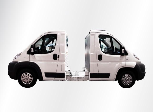

AlKO chassis is unpainted galvanised steel from the rear of the cab... fiat chassis cab is painted steel throughout.
ALKO chassis is fitted by the converter, not Fiat.
The cab is supplied without a chassis from the cab backwards or the fiat chassis is removed and replaced with an ALKO by the converter.
This is how they are transported/delivered.
Mine is Fiat chassis cab
