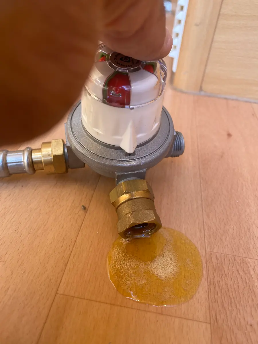

The external gas point supply to my Cadac BBQ seems to be getting slower and slower. I've read that you can get a build up of oil/wax in the pipe. Has anyone come across this? If so how did you clean the pipe out? Thanks.
More likely the regulator pressure dropping 🤔
Regulators are often changed due to getting gummed up eventually. Thankfully not expensive and new pipe every ten years too.
Can this 3 way valve be cleaned out ?
Thanks for your replies. I'll check the regulator but I'd discounted that due to stove, truma and fridge all work fine on gas. Just the external point. I'm going to check my suspicions by plugging the cadac into a separate patio gas supply to check it has a stronger flame.
