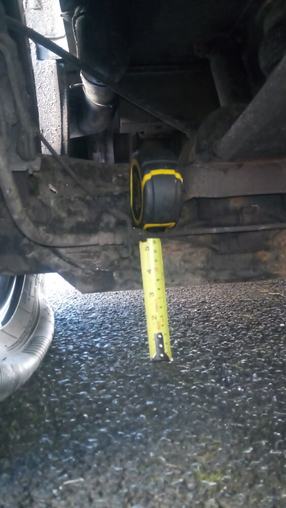

I carry a small two ton trolley jack..its the only thing I could find that was suitable to fit under the rear axel..and even then after getting a puncture recently I found that when the tyre is flat even the trolley jack won't fit under the axel the clearance is that poor..
Was lucky that I could get a bit air in the tyre and then slip the jack in..

I mentioned earlier about the lack of clearance to get a jack in on my back axel..
And i remember making a note of it to try and sort a suitable jack..
Never did find a jack that would do the job on its own ....ie fit under the axel and give sufficient lift to change the wheel in one lift..
I was lucky and found ( by accident ! ) a very low bottle jack.. That is what I have been using for the past 5 or 6 years

I saw the same problem on ours with low clearance under back axle. You can get low profile trolley jacks. Think ours is 70mm height when closed down. I got a 2T jack which is, as you say, straining a bit on each corner, but does the job.
OH got ours from machine mart. Much better than the one that came with the van!
