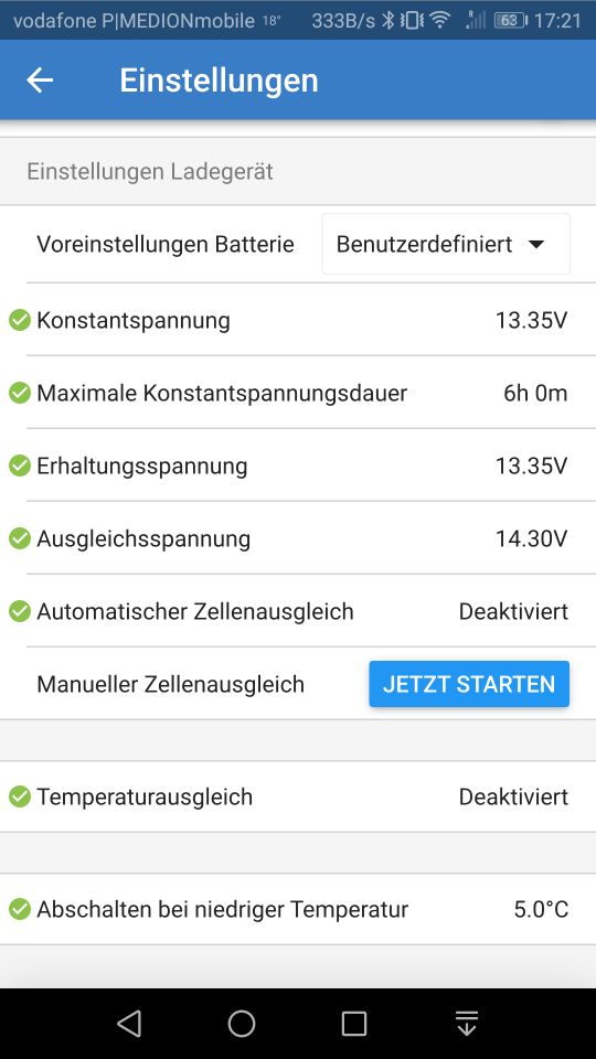

The guy who wrote the article charges predominantly with solar so his solution is pretty easy on the face of it, and yes possibly he has over thought this slightly. Quote below from the blog,
Control the state of charge of the lithium battery itself.
I figured it would be easiest if you just did not fully charge the battery, if you did not need the full capacity anyway. For example, during summer holidays, when the solar system provides a lot of energy and is often consumed only slightly. Switching off the solar system would be a way - but it means that the battery would be discharged during the day again, which means unnecessary wear, because solar power is cheaper than lithium electricity. So there has to be a way to teach the solar controller to gently charge the battery without constantly charging it to 100%.
This function would also be useful if the motorhome is unused at home in the sun and no electricity is consumed.
Solution: Programmable solar charge controller
Vicpt charge controllers from Victron Energy are ideal for LiFePO4 batteries
Victron Energy's MPPT solar charge controllers can be easily customized with a self-made charging curve to achieve thedesired mode of operation described above.
To achieve this, the charging characteristic is set on the solar charge controller so that the battery can not be fully charged even if the sun is shining around the clock.
The same goes with a 230V charger , if the motorhome under the carport can not be supplied with solar power. In order to protect the battery from uncontrolled over-discharging by the self-consumption of BMS and other miniature consumers, the system must either be completely switched off, or you connect a shore power charger, which keeps the battery permanently in ideal state of charge by a special charging voltage.
Hach is the one effort now thinks so many. I would say, to have to be on the lookout for a power outlet while vacationing would be a lot harder for me than switching over a charge curve on a charger every few days or weeks.
Charging with solar power - that's how it works
The Victron Energy can be programmed via app pretty easy. This is possible with any Victron Energy SmartSolar MPPT charge controller or with the BlueSolar MPPT charge controllers with additional Bluetooth dongle.
I have created and saved three charging characteristics. Depending on the desired operating mode, I can give the controller the right profile in seconds.
I have put together 3 characteristics, which I can call just as you wish.
  • Full performance (100% SOC)
  • Summer operation (about 80-90% SOC
  • Storage mode (50% SOC)
The following parameters are stored in the charge controller:
Power mode - always full for bad weather
Charging curve for full capacity and cell balancing
Here the battery is charged according to the Victron recommended charging curve. For normal operation this is ok, if always the full capacity is needed. When I see bad weather looming, I activate this profile the day before so that I have the full battery capacity for the bad weather period.
Setting values for the MPPT controller:
  • Constant voltage 14.2V
  • Maximum constant voltage duration 6 hours
  • Maintenance voltage 13.5V
  • Compensation voltage 0V
  • Automatic cell balancing deactivated
Summer operation - no full charge
Summer operation, the LiFePO4 battery is spared
So that the lithium battery does not stand around every day, I lower the constant voltage and maintenance voltage slightly. For this I activate the cell balance for every 30 days with 14.4V.
This setting corresponds to about 90% charge level. However, whether the 90% are achieved depends on how empty the battery was in the morning. Due to the low constant voltage, the maximum charging current breaks down sooner and it takes some time until the 90% is reached. Here you can also play something, I set the constant voltage in the summer partly down to 13.7V, if I have more than enough solar power anyway.
  • Constant voltage 13.6-14V
  • Maintenance voltage 13.4V
  • Compensation voltage 14.2V (Victron to 2018 14.4V)
  • Automatic cell balancing every 30 days
Storage mode - steady state of about 50%
Storage mode for lithium batteries.
If the motorhome is not used and is in front of the house in the sun, the storage mode for a charge retention at about 50-70% charge state. For the lithium battery that is much more relaxed than when it gets anew every day with 14.2V on the cap.
  • Constant voltage 13.15-13.35V
  • Maintenance voltage 13.15-13.35V
  • Automatic cell balancing DISABLED
