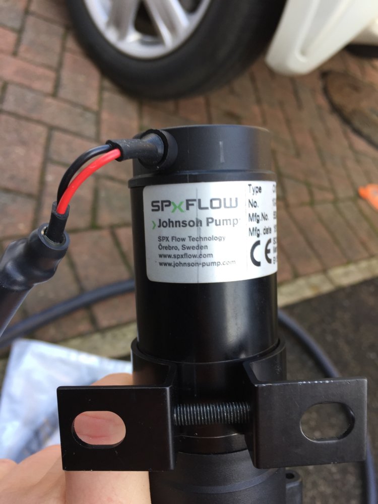

I had exactly the same problem with my circulation pump, it was a very slight leak from the pump, I only noticed it as my coolant header tank was slowly going down and then I had a storage bag in the locker and that was stained. Anyway I replaced mine with a Johnson SPX flow pump and never had anymore problems. Have a look to see if they have used a brand new Johnson pump as they ‘may’ have just tightened up the screws thinking it would reseal. It needs a new pump!

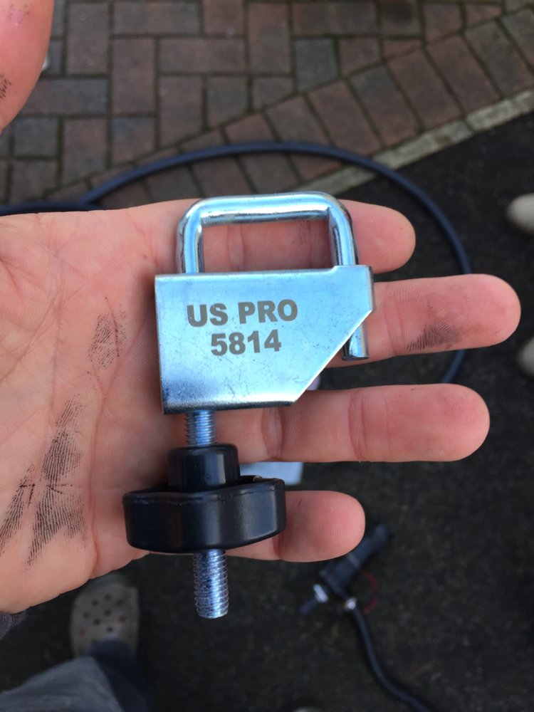

It’s not a difficult job at all, just clamp both pipes with pipe clamps and replace. The pump is approx £100. Here are some pics of my pump change:
Old pump:
New pump:
Pipe clamps:
New pump ready to install:
New pump in situ:
Dave.
