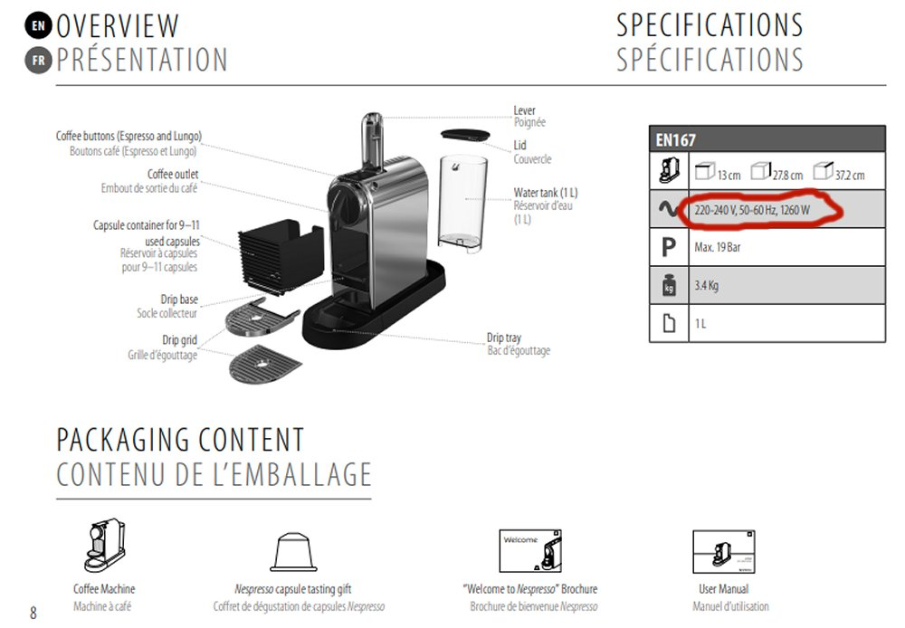

Not far off, In this manual for a Citiz, it states 1250 w on the specifications page.
Missed the link off but posted above.
I thought the power seemed low, I just checked the spec it is 450 - 500 watt it's a very small one.
Edit:
Might have been looking at the milk frother, so I got it wrong.
There are other ways to make good coffee,
and lighter solutions, too...
Are you sure you are not getting mixed up with the milk frother ?
This is from the Nespresso website.
