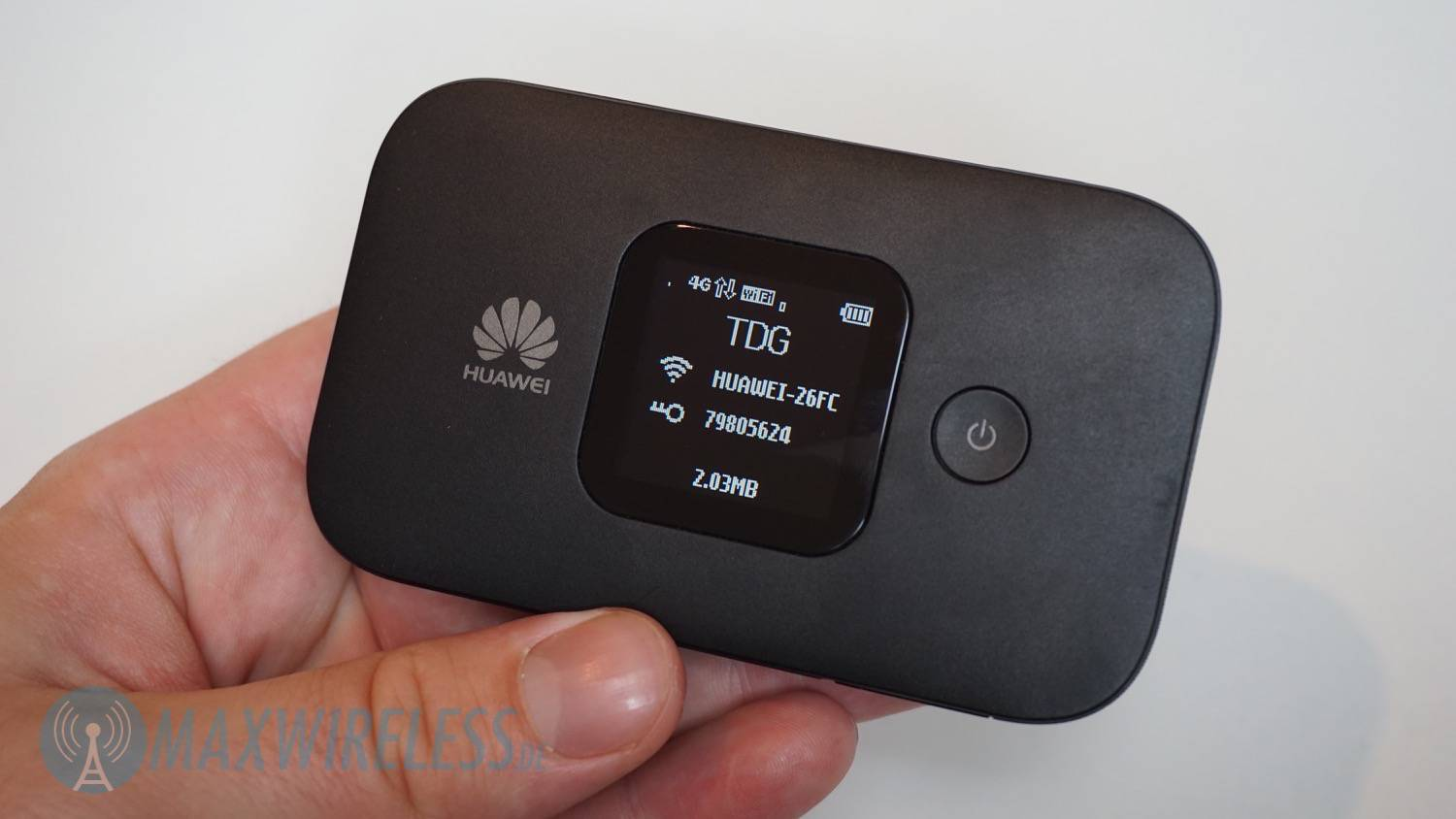

I don't know if you've sorted it yet but as has been said, if you are using the app the admin/admin combination won't work. When switched on the MiFi should look something like this:
The default user name is admin and the password is the 8 digit number you can see on the screen opposite the key symbol. The writing above this next to the WiFi symbol is the SSID of the network. This is what you will see when you try to log in to the WiFi network from a device. The same 8 digit code is what you also need to log in by WiFi.
