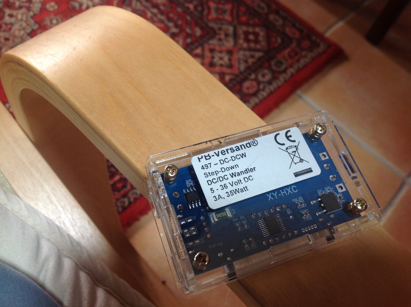

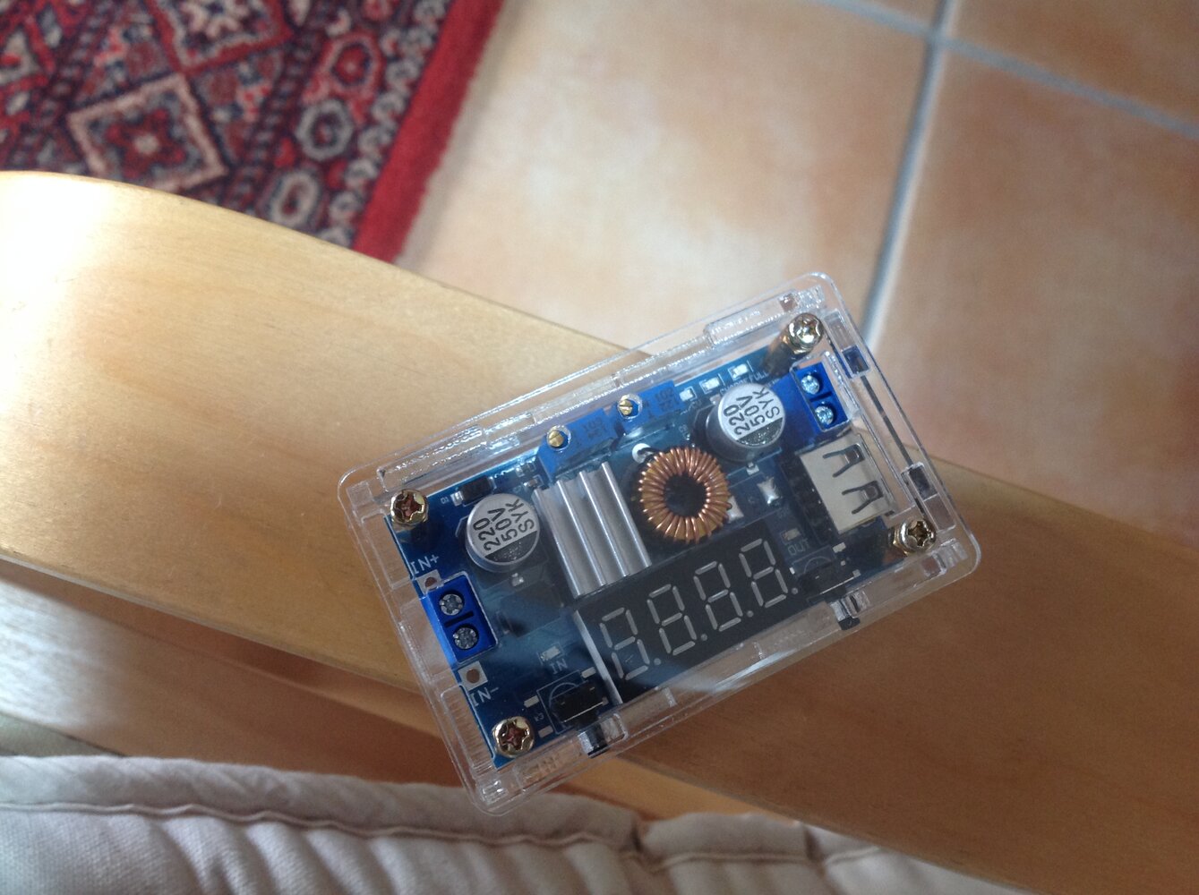

I have just taken delivery of such a step down converter (see photo) for using with my Huawei Mifi that, in our French house, is plugged in all day. This is the only way we can get internet. Trouble is, the only instructions are in German.
Can someone please give me a Noddy's guide how to use this device. Feels very well made.
Can someone please give me a Noddy's guide how to use this device. Feels very well made.View attachment 403937
If you are only using the USB output you don't need to do anything.
The buttons allow up to select what the display shows, input voltage, output voltage/current/power.
The multiturn pots are to set the output voltage & current for the terminal outputs.

This one looks the same as the one I have yes it does have the cut off.
TWIS but yours is a little cheaper :rofl:
(Even same PCB part #)
