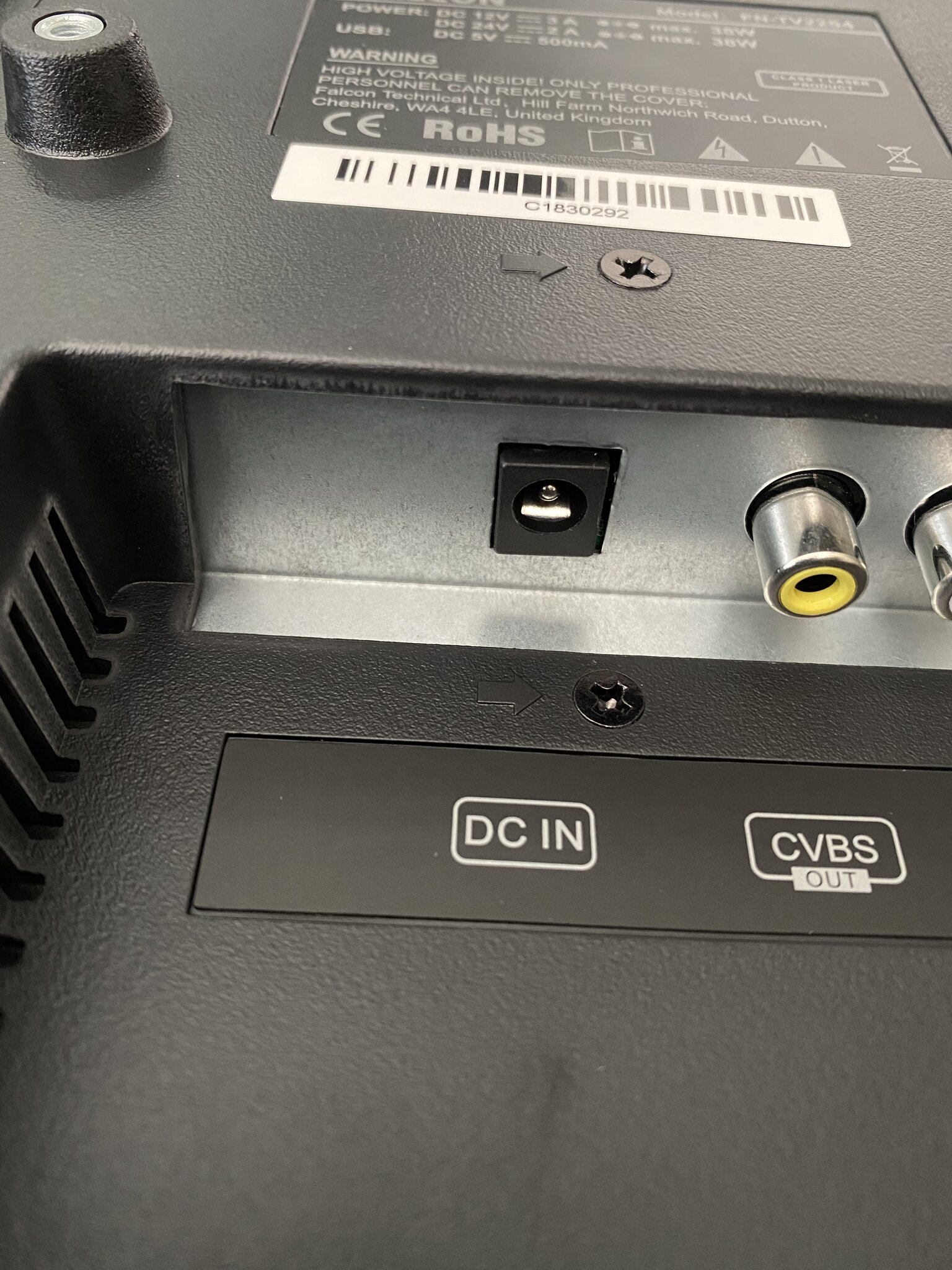

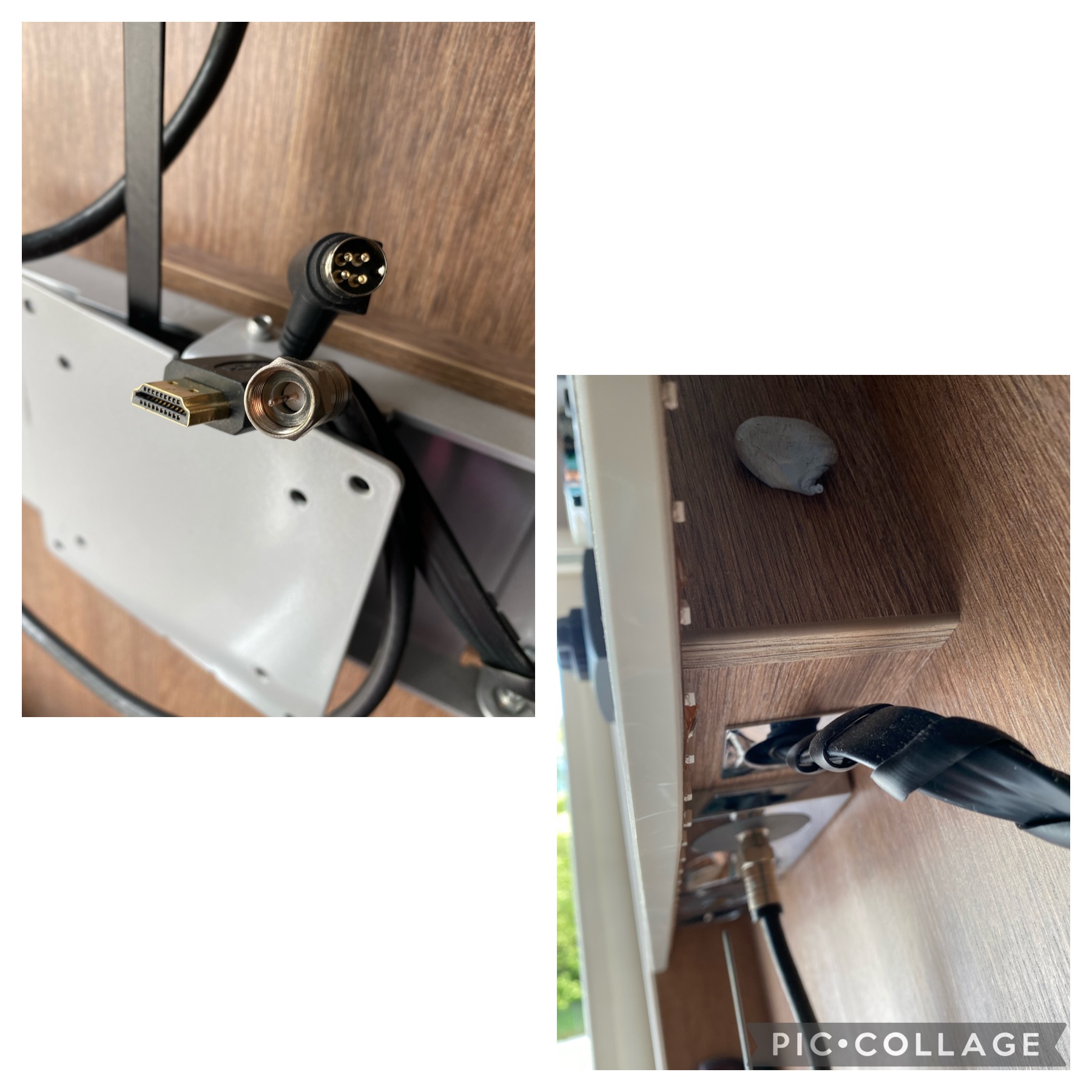

Can you help with problem.
Changing TV for Motorhome
Pic left is new 12v lead.
Pic right is connection on mh from old 12v lead
Is there an adapter I can get and if so what would I search for?
12v to me is 12v. But obviously not!!
Thank you

Where is the old 12v lead? Perhaps that can be adapters at the TV end
The old 4 pin one is fitted in Motorhome by dealer 3+ Years ago. But the new lead is the big standard 12v push in socket like UK vans have and on dash in front
Try typing 4 pin camera connector in Google lots come up similar to what you are looking
The new tv has the single as pic left above The lead I have to plug in is this plus HDMI and Sat cable all disappearing up a hole to god knows where
carol
This is socket on new tv
carol
What's on the other end of the lead in the left picture?
Here it is
The 4 pin lead will have 2 x 12v+ and 2 x 12v-.
You could cut off the old plug and, using a multimeter, find which wires are which and pair them up. Fit a new phono plug to suit the size on the TV.
Disconnect the battery before cutting.
Thank you. I’ll explain that to Duncan. I am not too good at these things.
Thank you. If he doesn’t get it we have hopefully a neighbour that can

That’s lead we have already. It doesn’t appear there is an adapter which would allow that plug to have a bit like the one with the single lead. We have a lead but it appears we need to find out how and where the 4 pin one is connected. It just disappears up a hole!!! Wish I understood all this lot 😰

Sadly no neither of us have these skills. Looks like today will have to try to trace existing lead on Motorhome and see if we can change it to the single type
