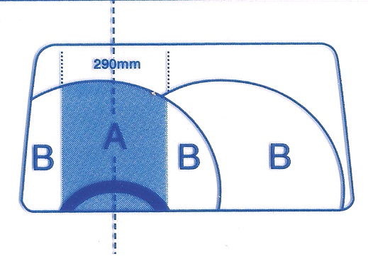

Remind me not to buy off you Rob;)
Doesn't bother me either as mine is also in an MoT fail spot as it unfortunately happens to be the best place for them but mine is removable for the test
The purpose of my post is due to mounting methods now trending toward a better and more permanent mounting system it could mean MoT Fails for those that don't realise, and result in an inconvenient if not expensive destruction of a sticky camera mount along with the risks involved of removing such an item
I can't think of any tester loosing sleep over telling you to remove it or fail, but many who would, over loosing his job because he wanted to appear reasonable.
Remember we get ingognito vehicles in for test many times a year from both DVSA and Trading Standards, and its these silly little faults that cost many their livelihood
so you might just be setting your friendly tester up for a fall :rolleyes:
If your mount is in Area A it must be smaller than 10mm
If you mount is in Area B it must be smaller than 40 mm
Anything larger than these figures in these areas is an obstruction to drivers view for the purpose of the Mot test.
even IF its not in your line of sight

For the record and to demonstrate how pedantic the rules can be
next time your in you car, take a look through zones A and zones B
Take note of how much of the road you cant see because of your bonnet
are things stuck in that area an obstruction Yes or No have a guess
