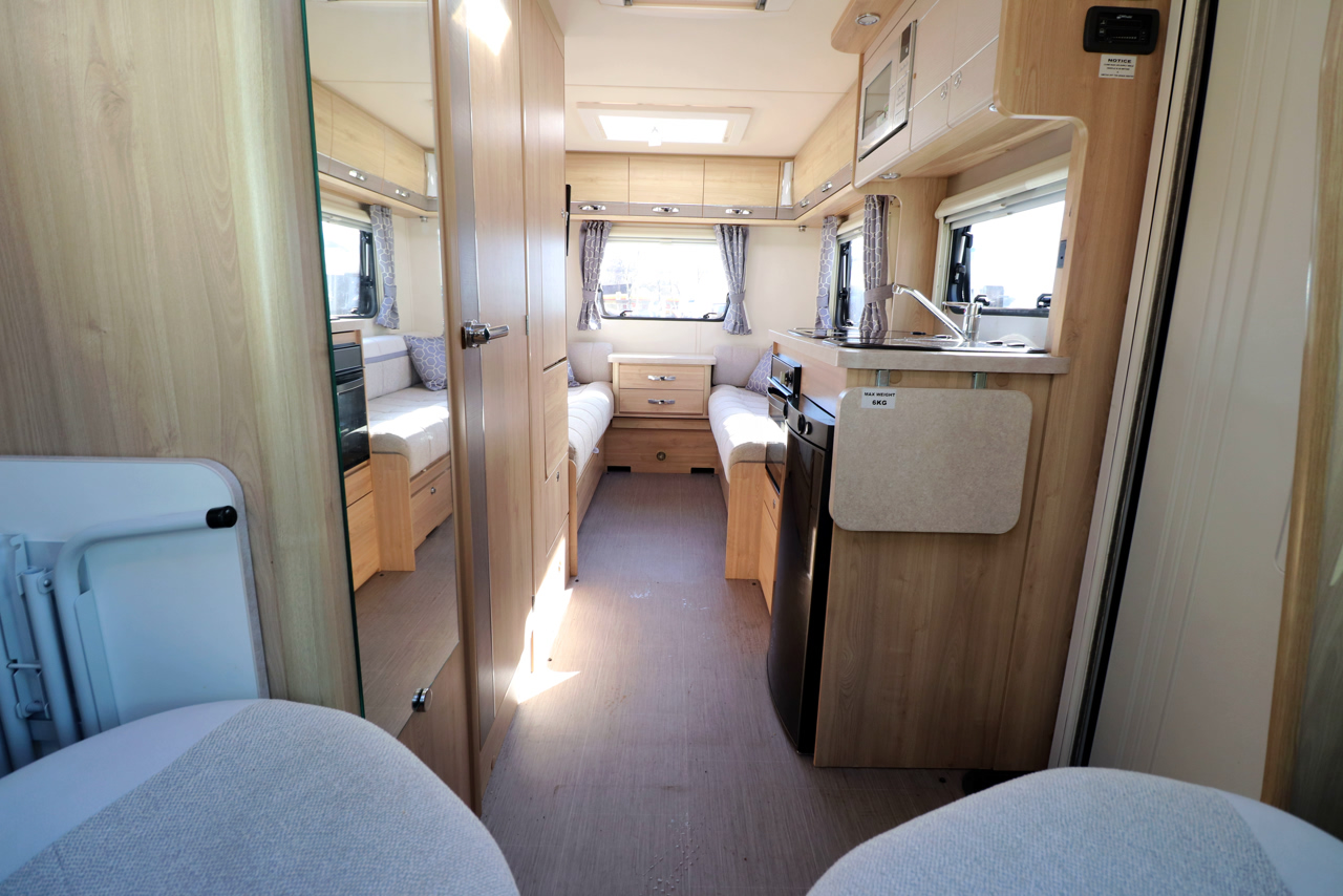

What year/model of MH have you got? Any photos of what it's like inside the hab door on both sides?
Pictures of the target area for the proposed handle, note the fold down table that ended up be semi detached

Now I know what you have I've managed to find some images on the web of the 2 areas.
This shows the panel next to the cab, this will be the easiest place to put a handle as you can bolt right through.
The kitchen side is more difficult, however if you remove the external upper fridge vent cover I suspect it will give you sufficient access to be able to bolt through that side too:
I'd put 2 handles in anyway, at the same height and distance from the door as being able to evenly pull yourself in is a lot easier than just one sided.

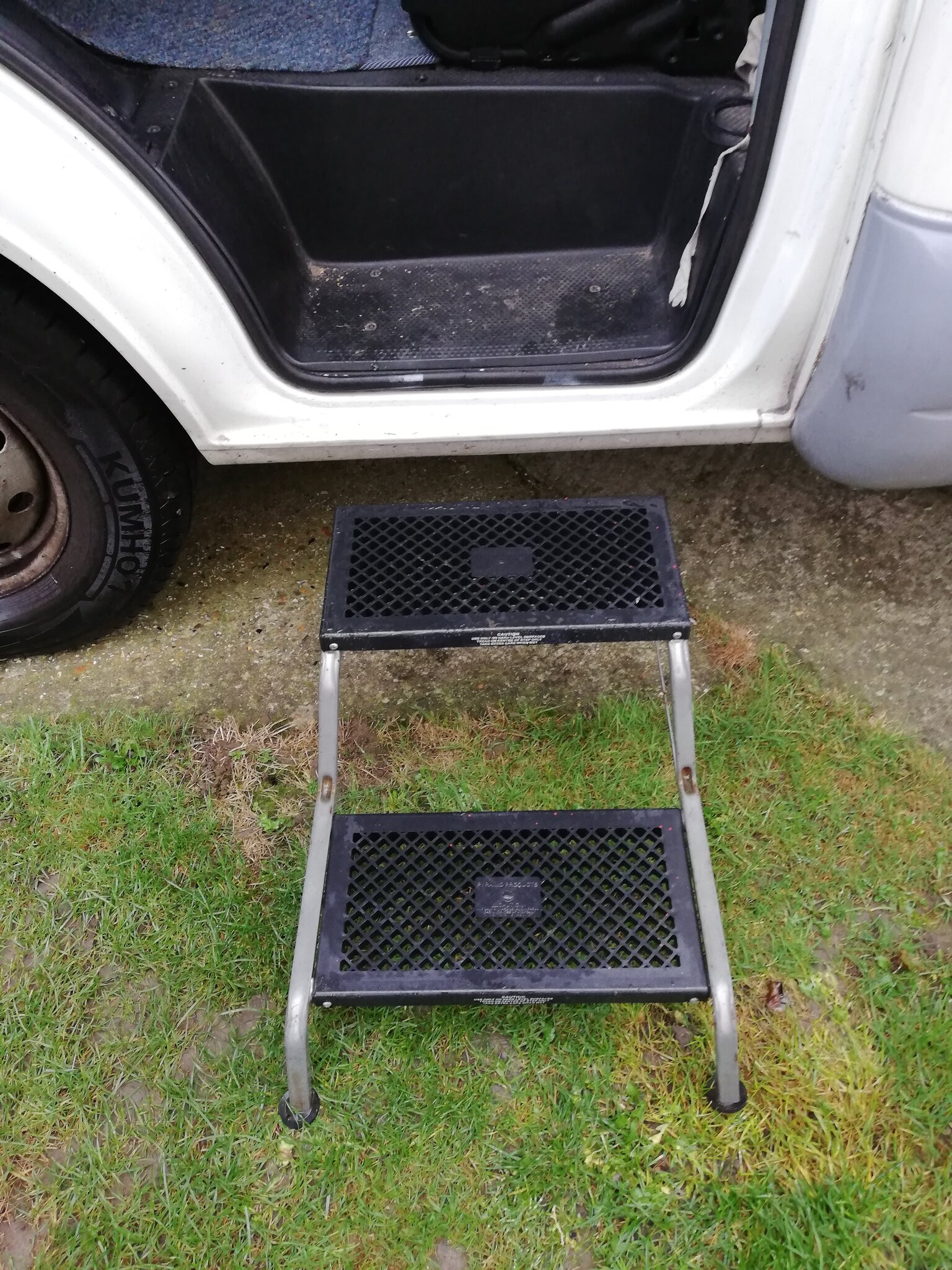

can she not get in passengers side as my mrs now has to as same reason i use a double step like this with a strap to pull on
