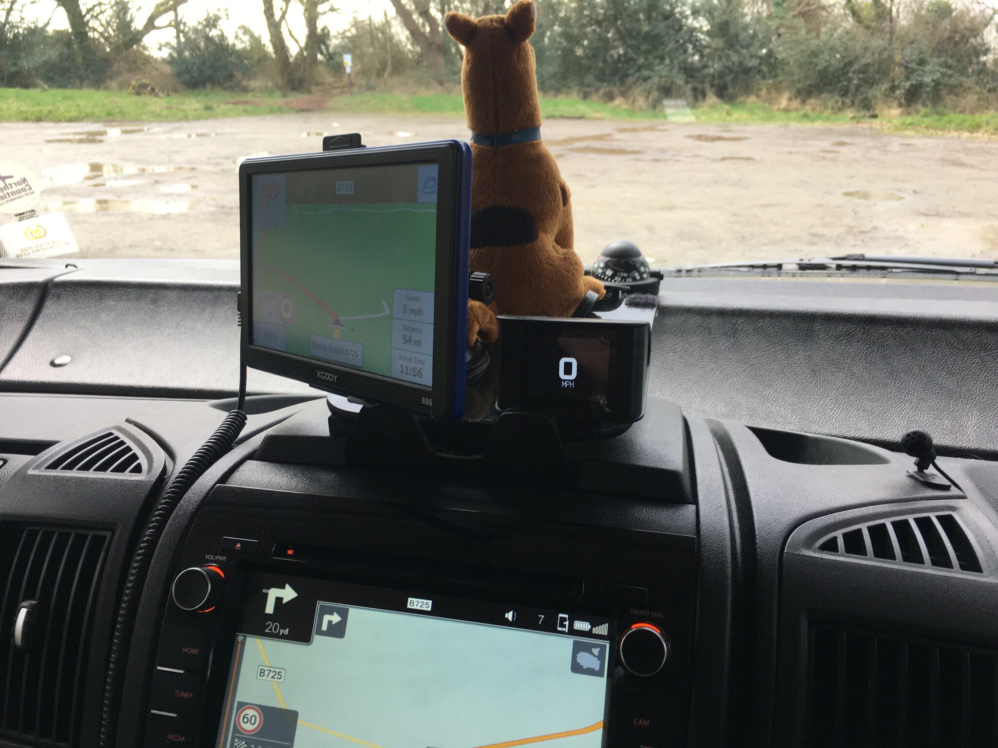

by an OBD port heads up display from Amazon and set to kph
I think it has about 11 different settings but i only use it on kph, it literally takes 2 mins to fit in Fiat Ducato
I never drive anywhere without it
Al
