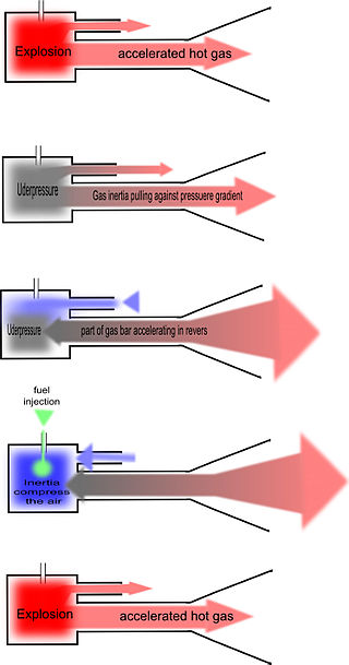

With mine I used the centre section from a Honda S2000 prop shaft for the chimney as they are very thin wall and a pair of con rods welded from chimney to fire box as supports and lifting handles etc. Get It really going and it chuffs and puffs just like a steam engine as I suppose the chimney flow is causing air flow in pulses
