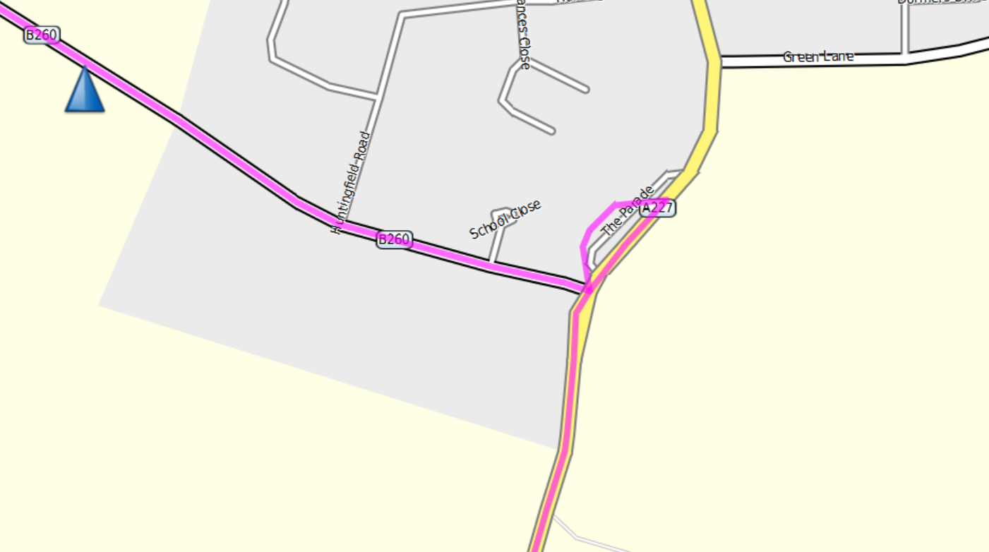

I have the Garmin 660 with all the latest software and maps. I have trouble with the unit repeatedly telling me the Charger Lead attached is not compatible for Traffic. I have been advised by Garmin how to cure this, including Master Resets, but it keeps happening. The lead works fine on another model.
I also have concerns about its routing as I have found a number of routing errors which I have not experienced on other makes. For a simple example in trip planner if you enter Meopham Green as the start and Longfield as the Finish. The error occurs at the junction between the A127 and the B260. It takes you through the shopping parking area before returning to the junction to take the B260. This is with the unit set for 7m long and 5 Tonne. By the way it seems to not like the A127 for Motorhomes. Goodness knows why.
Another example is asking the unit to take me to the campsite in Moffat travelling from the M6. It directs me into Church Place. I suggest you look on Google Earth to see how you fancy the challenge of the deadend.
Whilst generally it can get me safely from A to B its errors like these that do little to give confidence when I am in areas I don't know which is what we are usually using them for.
For those with the 770 have they cured these errors, which have been confirmed by others, and if so how is that possible.

Mine does exactly the same as yours. A routing error in the software I expect. To make matters worse, it's trying to turn into a no entry.

Hi PhilandMina
Its not a No Entry as it takes you in at the other end 25 yds after the B260 Junction that it then brings you back to.

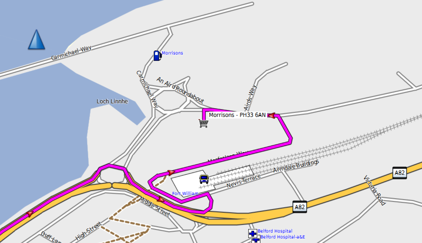

If you want another tester try getting it to take you to Morrisons in Fort William. It takes you via the Railway Station Car Park and the back of the store as used by the buses. You cannot get into the store car park without going right round the store. There is a shorter and better route.

Hi PhilandMina
I was looking at it the wrong way round. It is a one way system, you have to enter immediately you turn left to join the A227. More like 2.5 feet than 25 Yds. Of course, this makes a joke of this routing selection.

Hi PhilandMina
Like this -
It's because you're better going to Lidls the other side of the caravan \ motorhome parking area!:whistle::giggle:

Lol that's some route. I'm in Wales fishing for the next few days and when I return I will post you a Google map picture of the lay by we have been discussing. It shows a one way sign near the junction and a no entry sign at the other end. However you look at it, it's a joke. Have you sent your posts to Garmin I'm sure they would want to know about these glitches and give them an opportunity to explain why they happen and correct the errors.

HI PhilandMena
On Gellynecks attachments the first one that takes you around the houses, sorry train station car park, but his route finishes at the entrance to Morrisons Car park but Morrisons is marked elsewhere on the map off Carmichael Way.
I have sent Garmin a number of cases of crazy routing in the area where I live. There have been a couple of changes but nothing with the others. Their mapping did not include major road changes at a Junction with the A2 that had been there for over 2 years. The Garmin seems to totally ignore the A127 unless you start on it. It also ignores the exit for the junction we take from the A2 when going Home instead it goes to the next junction and bring me back to the junction which is another 2+ miles. There is nothing wrong with the A2 exit junction near us as it is used by huge lorries to go to industrial units as well as a large Sainsburys. It used to ask me to turn into a layby drive through it and at the end turn Right across 2 lanes of the 4 lane road whereas now it says go to the roundabout 100 yards further on and go round it. Simples.
