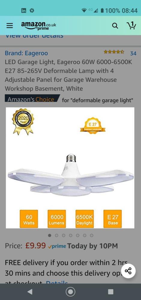

About to build my workshop in the garage, currently an old strip light. not great..
Im wanting to replace it, these type keep popping up..
Any good or is there a better alternative?
I recently tried these.....they are smaller than appear in pictures but are simply excellent. Remember to buy matching socket for them to screw to of course.
