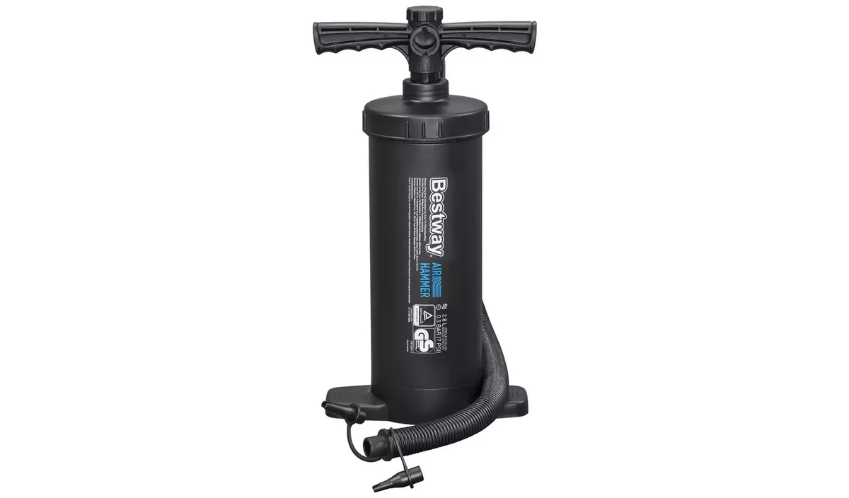

I use a hand operated air pump I have for blowing up the air awning and inflatable canoe . . . ..
but do it gently, dont want to blow a joint ..just hold the inflater nozzle by hand over the tap spout and listen as it blows out the water at the drain point ..
