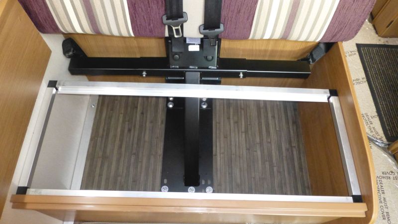

To try and give you some idea of what would be required before you even look at type approval. We've got an Auto-trail Savannah with the type approved optional half dinette belted travel seats fitted.
This is what they look like -
W
This looks exactly like the seat belt mountings fitted on the rear seats of our Chausson Flash 10, so I'd hazard a guess that MH manufactures go for a standard seat belt fitting frame (the black metal in the photos) and build the rest of the seat round it. Ours is totally filled with the fresh water tank in the base of the seat. Therefore could you not get a frame either new or somehow secondhand and then build your seat round it. Or fit an entire seat from a different MH ?
Virtually Identical to the Rapido Layout.(y)(y)(y)(y)(y). Except the Fresh Water tank is moulded to fit around the "construction". Edit "snap" Geordies!!:D
