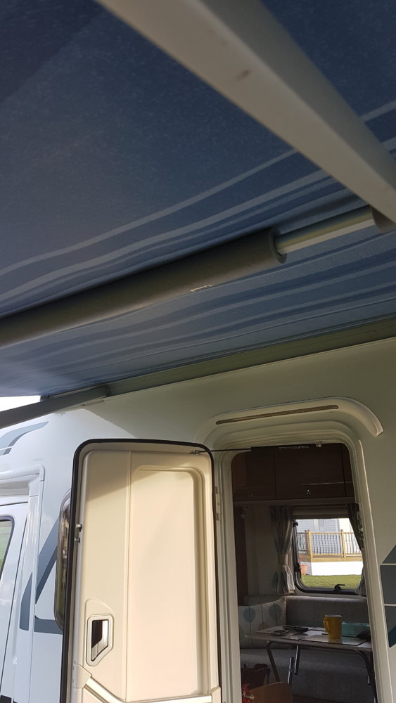

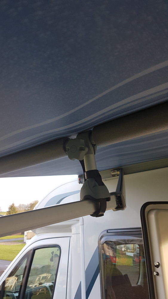

1st time I put it on although fine, where the Fiamma bar knuckles (bike carrier fittings) pushed into the canvas it caused a `V` in the canvas from the bar to the front of the canopy.
I bought 4 x 1m Lengths of pipe Lagging (22mm centre) from Screfix for about £3.50 and fitted them on to give the bar an even fit along the length of the canvas. The Lagging has a split along the length so easy to fit.
Works and looks great fitted on.

be interested what you think after a few days in hot sun . i was looking at one bout was concerned it would stretch the awning canvas in hot sun.
I could of course be completely wrong.. it has been known.. :doh:
Yeah considered that. Sure Fiamma have aswell. Dont expect much stretch in the canvas really, probably more from when 1st new. The canopy tensioner will take care of that I am sure.
