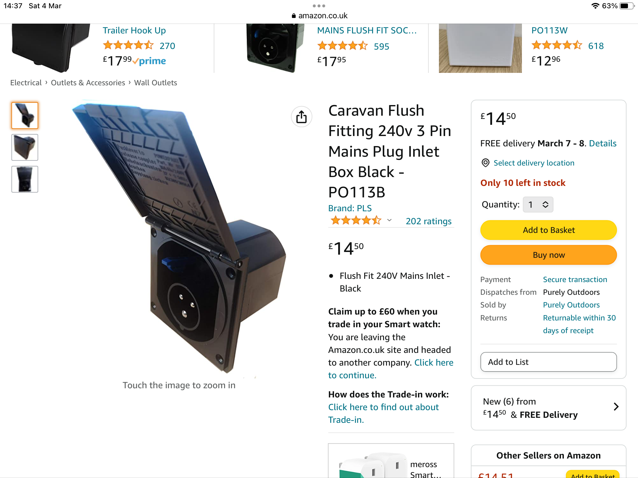

Can anyone recommend a genuinely good quality flush hook up box as fitted to the side of your van, the bit where your hook up cable plugs in, having replaced mine due to poor pin connections "fizzing" and ultimately discolouring the pin and plastic about 2 years ago I find I have got to do it again!
Just want a good quality part rather than finding yet again it's Chinese cr.p
Recommendations appreciated.

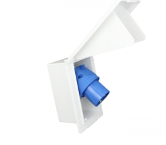

Depends which type you want,pays your money and make your choice! we have the second type and put the rt angle plug on the end of the cable so it hangs straight down.

Never seen the right angle plug before, I like it.

Unfortunately I have returned to this thread with a warning which I feel is necessary, rb62 you are quite right with your comment re pays your money etc, having struggled a bit to find a 90 deg socket as in the picture, I broke my own rule on never using ebay again and purchased the 90 deg socket, what a piece of crap! no criticism rb62 as you were being helpful by showing what's available not recommending, the wiring into this socket is connected by trapping the wire strands under a screw head splaying and twisting them as you tighten the screw, the socket has a CE mark on a sticky label which apparently is legal but you can buy these online! The socket is actually supplied by Pennine Leisure Supplies to the ebay seller JNC camping under the brand of Power Part Products, I emailed Pennine Leisure Supplies and queried the safety of this socket and received the following response:

I eventually found one on Amazon, I was a bit dubious as to what this one would be like, it arrived and was very much heavier and better quality, the wires were entered into the little "tubes" as we are familiar with and the strands are contained within the tubes as the screws are tightened, it had a CE mark again on a label but also moulded into the plastic.
