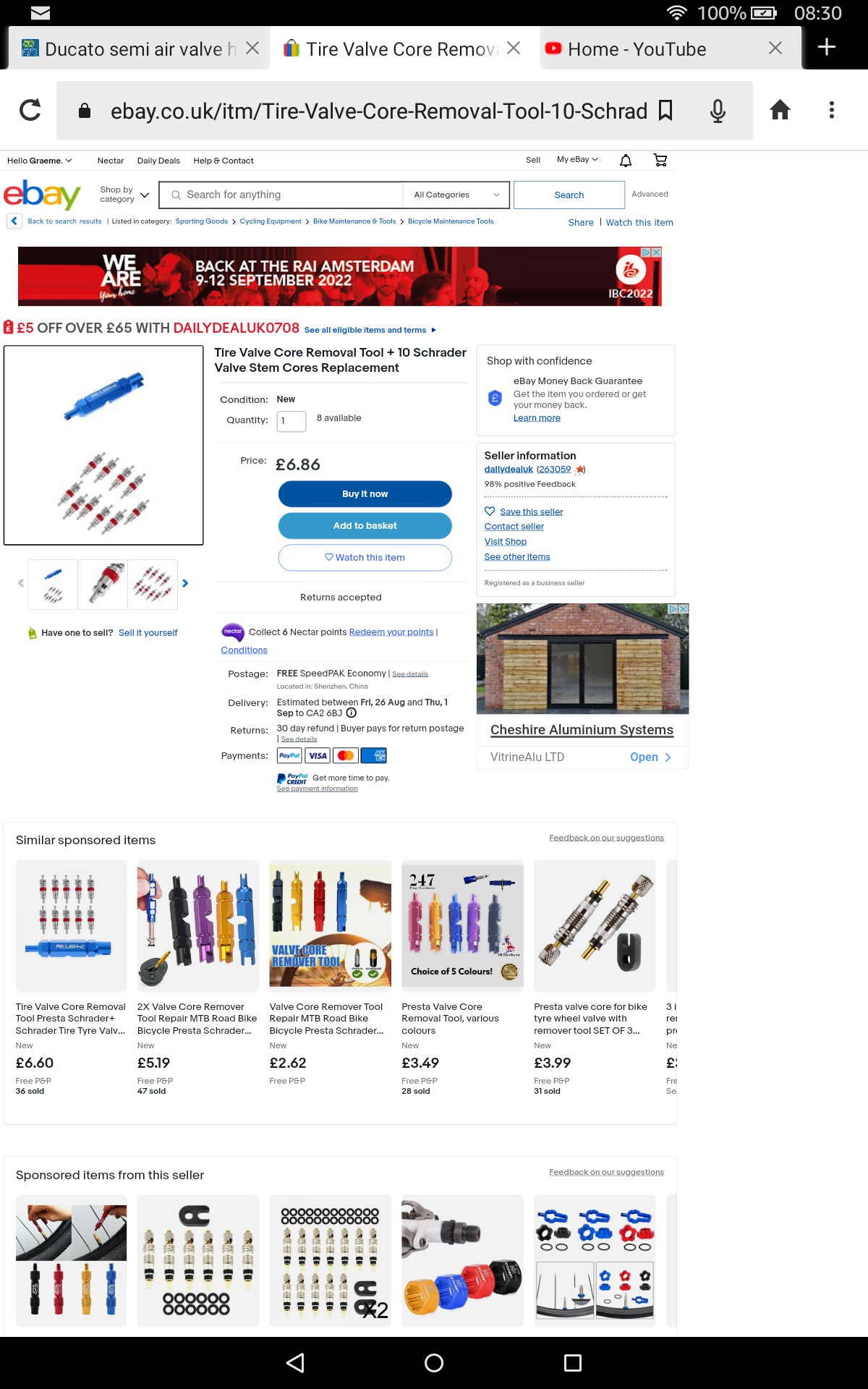

Schrader valves generally only leak from the core which is replaceable or if it has worked loose. Get yourself a kit like the one in the attachment, or call in at a friendly tyre spot and get them to check it out. My neighbour's car tyre had a "slow puncture" a bit of spit across the top of the valve indicated a loose core, 2 minutes to tighten it up !
You might get a tool and core from Halfrauds ?

If it was like a normal car or push valve it would have sorted it ,not seen one quite like it.
