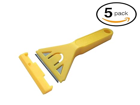

When I removed an awning from our previous PVC I had a hell of a job removing the Sikaflex from where the brackets had been, I used a winder scraper like the below, but before I used it I rounded off the 2 sharp corner points so they couldn't dig in. It was then a case of gently scraping away at the adhesive taking care not to catch the roof.
