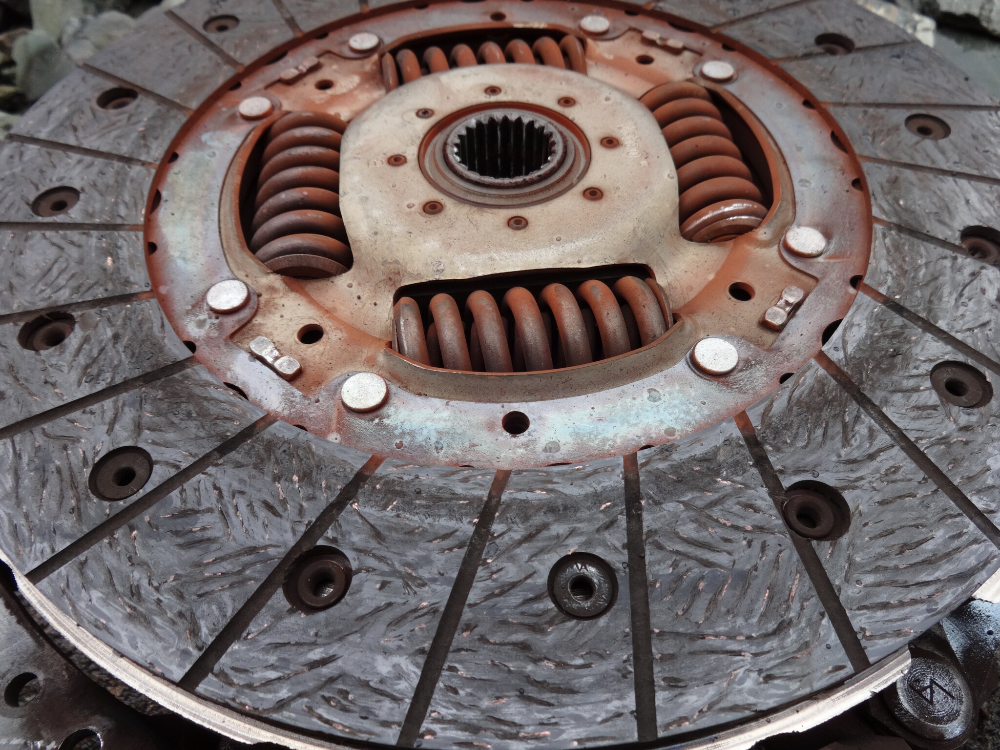

This is my clutch 3000 miles after it first slipped on a mountain pass in Germany
That clutch looks good? was it the auto-tensioner on the cable? seems there may be a theme/ pattern amongst you?
