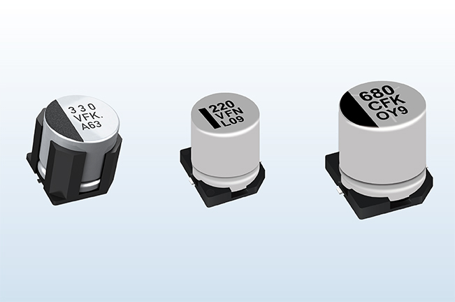

Back when I was in the industry (building and selling PC's) We had one customer return his stating it didn't work any more. We asked for details and he sheepishly told us he was using a hoover to suck out the dog hairs and dust and he accidentally knocked something on the motherboard which came off and shot up the hoover. He retrieved it and had it/them in a plastic bag. He had taken a bunch of smoothing capacitors off the motherboard. So be careful when you are cleaning.
edit: Thought I had better add a picture to show what I meant by smoothing capacitors.
