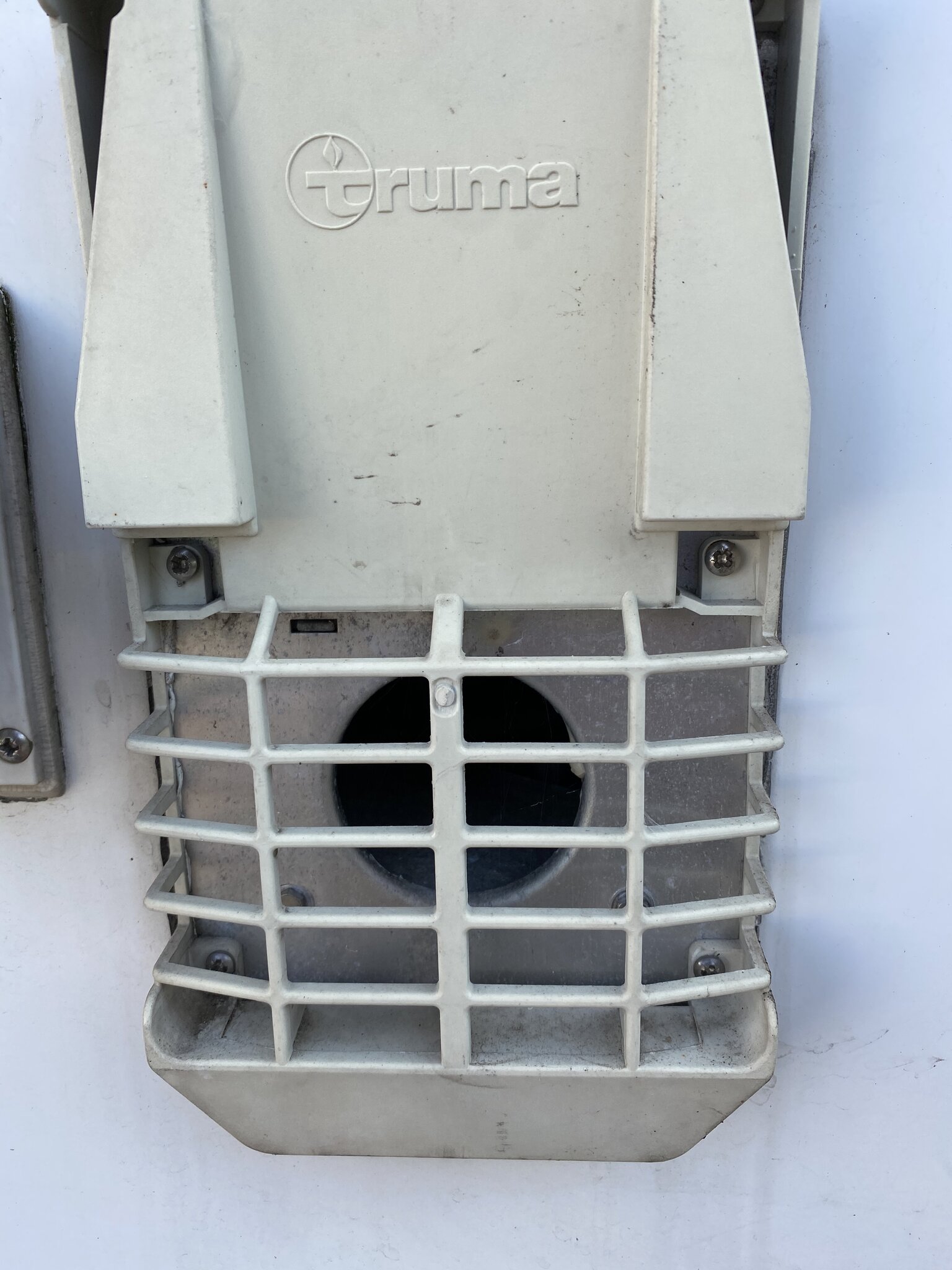

Hi again, I send you a picture of the output vent. It has been silicon and screwed down. I will take it off later. I have been constantly trying the on,off routine trying to get the gas through. I send you the type of gas tap it is. I can access it but cannot see it. I hope I am using it in the On position...when I try to use it in the supposedly Off position...the two "clicks" are much shorter in time! first click, then 5 seconds after the second click. Will send photos separately.

Is it like the picture in post 2?. The first picture is with the cover on the second with the cover removed. It sounds strange that it's siliconed on that makes me wonder if you're trying to take something off that shouldn't come off!

Hello Ruby, thanks for your interest. The cover is just a louvered 10x4" aluminium vent. See photo

That is not a gas flue, are you sure the boiler works on gas? A flue looks like the picture in 2nd post in this thread. I advise not running on gas until it is checked, if the gas does light I don't think it would be safe.

You really need to get the correct balanced flue cover as this allows air to be drawn in from the outside whilst exhausting the fumes through the higher part. What you have there is a bodge of the highest order in that when it light s it will be trying to run using the upper exhaust gas fumes being vented downwards to be drawn in where clean air only should be.
This is the actual cover that should be fitted in place of that alli louvre. The one on the right goes over the centre aluminium that you probably still have fitted. The external cover, on the left fits when not in prolonged use to prevent ingress of dirt & dust.
https://www.ebay.es/itm/25375829508...d=link&campid=5338547443&toolid=20001&mkevt=1
As said it needs the correct cover before you go any further, when a fellow member who goes by the username The Ex-Gasman firstly advises you, then pleads with you not to use it until it's been inspected by a professional it's time to sit up and listen.
