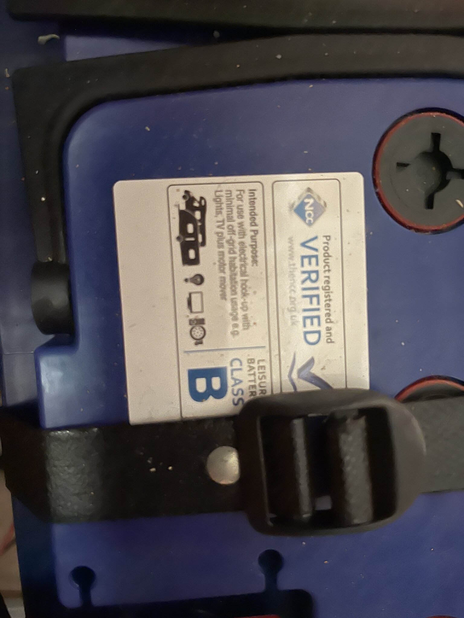

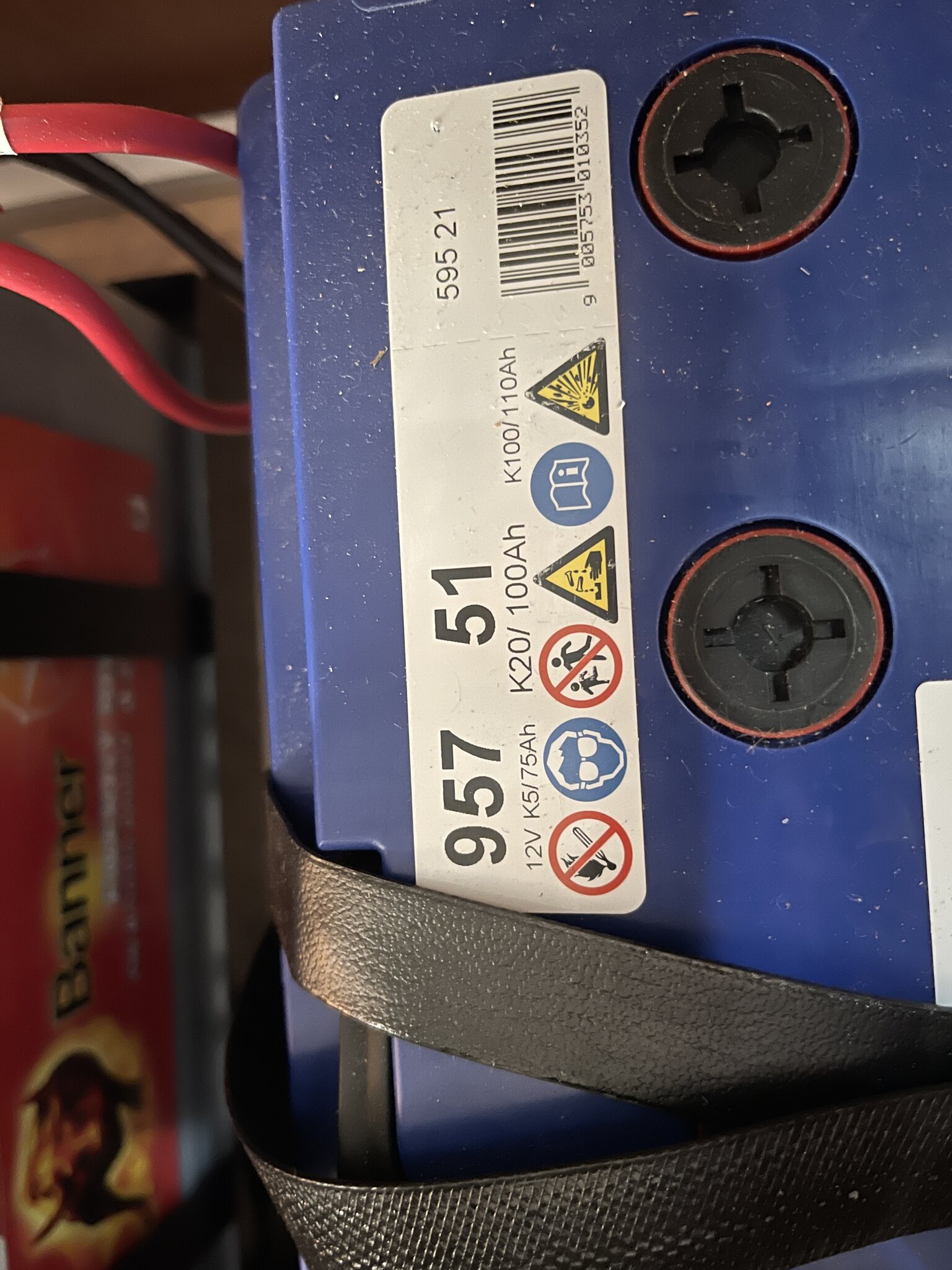

Ok I misidentified. Mine are not gel but wet, judging by the filler plugs. So first step may be to top up with distilled water ??

I have finally replaced my leisure batteries like-for-like. Two Banner wet 100/110Ah which I bought from Tanya. Thanks for all advice received. Job went well, I’ll report back on their performance.
