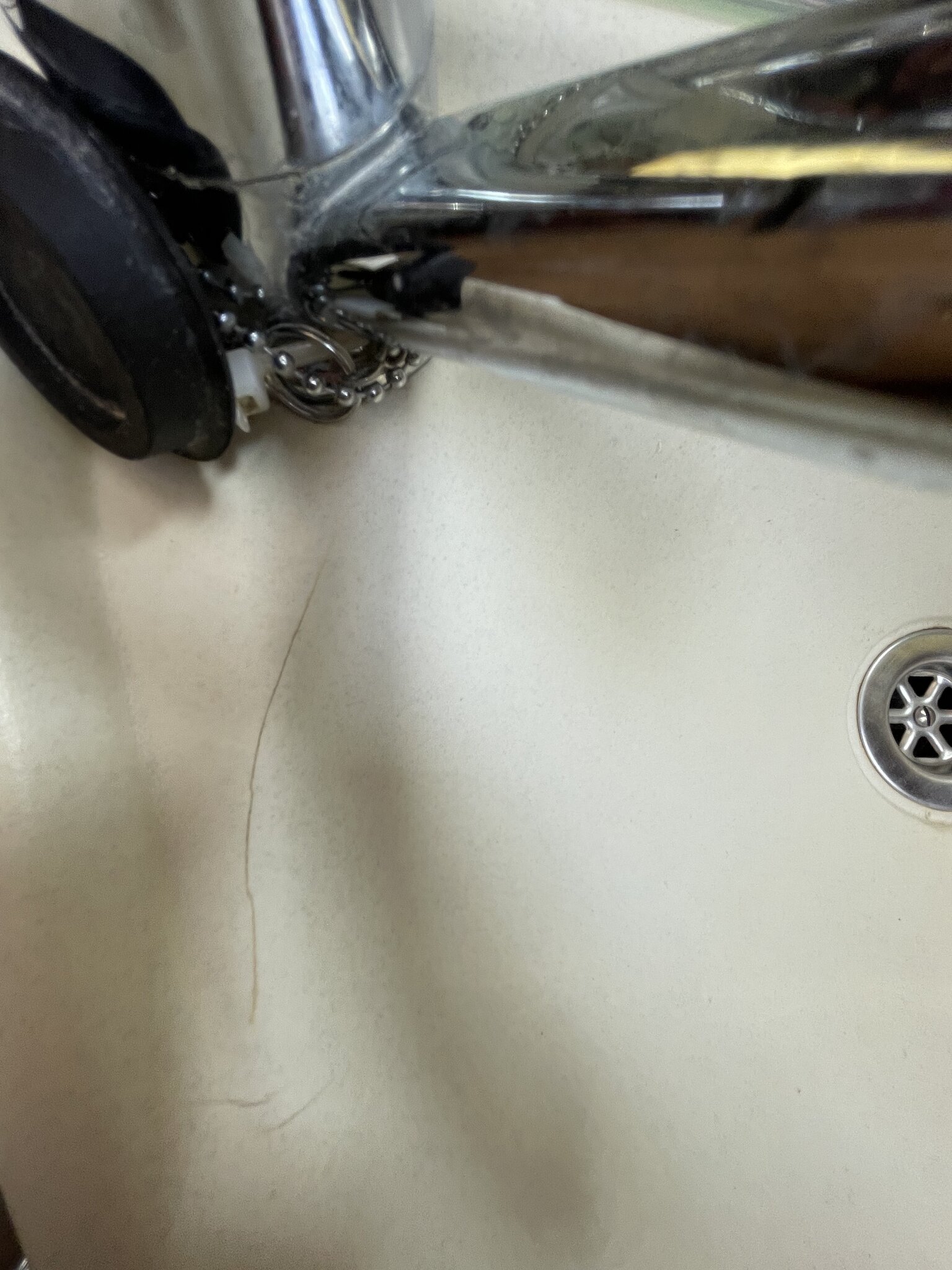

Advise please.
AutoTrail Delaware 2012, the bathroom sick got a crack how to sealed it?
I got a good liquid PowerBond, is that an option?
Thanks

Powerbond 806 is an adhesive (superglue) not a filler, Cyanoacrylates degrade if repeatedly exposed/immersed in water.
If it's fiberglass/resin then I would use a resin filler.
