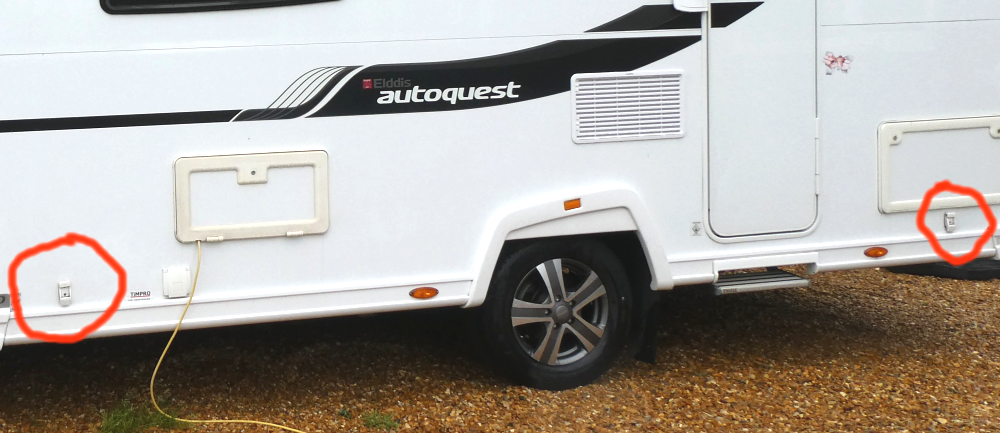

If you have a look under your van, it is likely that the outer side walls of your van extends passed the floor forming what would normally be called the side skirt.
I fixed our wall brackets onto the side skirt so the fixings do not go through into the hab area above the van floor.
I was concerned about a gust of wind catching the awning and ripping the brackets out so I mounted the brackets on a 4" square 2mm stainless steel plates to spread the loads exerted on the outer van wall and 3" x 5" 2mm plates on the back side on the skirt to stop any chance of the fixings pulling through if a gust gets under the awning trying to pull them out of the side skirt. Along with the aluminium Fiamma wall bracket, I'm pretty happy the awning will stay attached to our van in a freak gust, but we don't take chances if the wind starts to get up and wind our awning in, plus we rarely if ever leave our awning out overnight.

Easy enough to fit ? I assume the stainless plates were sourced / made separately
Fitting the brackets is no big drama, just careful measuring of where the brackets need to be fitted so the awning legs are in line with the point the legs on the casing and what's on the back side of the side skirt so nothings in the way. I bought the stainless steel sheet off of eBay, and made my own plates to suit what I needed.

We have a Thule awning and bought the brackets and fixed them on our Hymer. Others have used self tappers, but I drilled through and used stainless steel pan head bolts with spreader washers behind. Also used adhesive/sealer to make sure. I am sure that the little plastic bracket will break long before the spreader plates pull through the sandwich construction wall.
