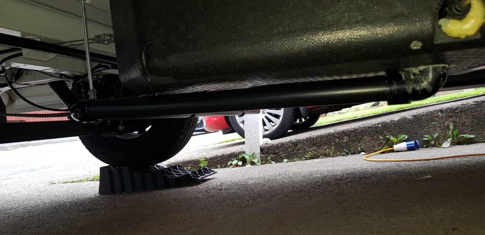

Hi Patrick, some photos of the underside , as you can see my waste tank is right near the exhaust box (1) and i can't route it to the passenger side due to having a skirt locker, photo (2) is a closer look ,if you have any suggestions i would be grateful.
