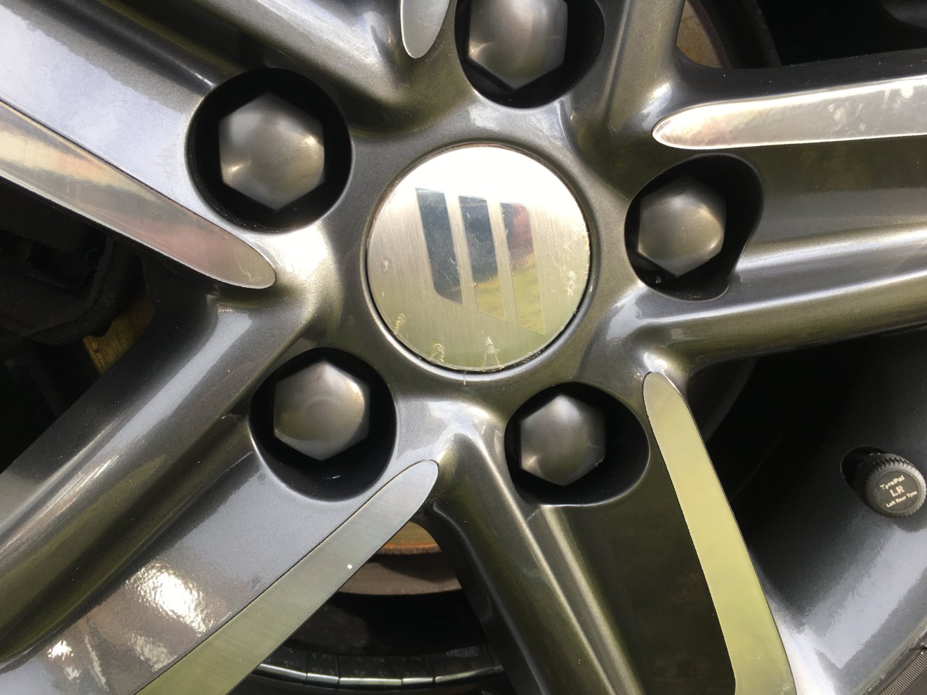

Our wheels were like this after two years and replaced under warranty, the wheel pictured is the replacement after three years, taken a couple of days ago. All four were bad, this being the worst. I’ve now had them done locally in gloss black.
Just waiting for black wheel nut covers.
