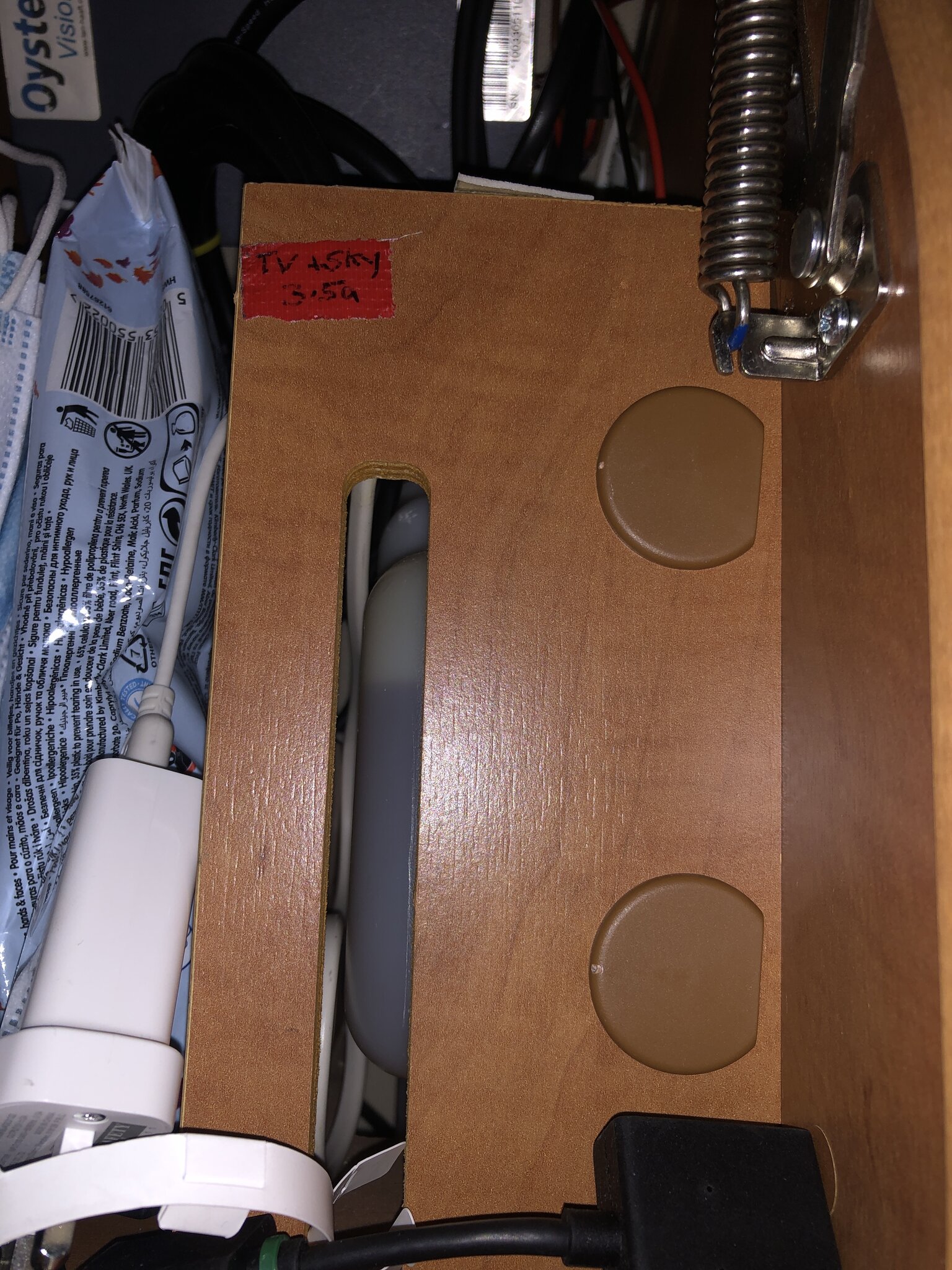

Have you checked the heating fluid level?
You should have a small header tank where, with a bright torch, you can see the fluid level.
On our C-Line the header is in a small head height locker over the side seat/ pull up tv.
There should be about an inch/ inch and a half of fluid visible.
If it’s low you can, very carefully, top it up by unscrewing the plastic cap.
Only add very small amounts at a time of Alde fluid or suitable antifreeze mix.
Best of luck.
Richard.
PS. Most decent motorhome dealers will stock it.
Best of luck.
Richard.
Thanks Richard, plenty in.
