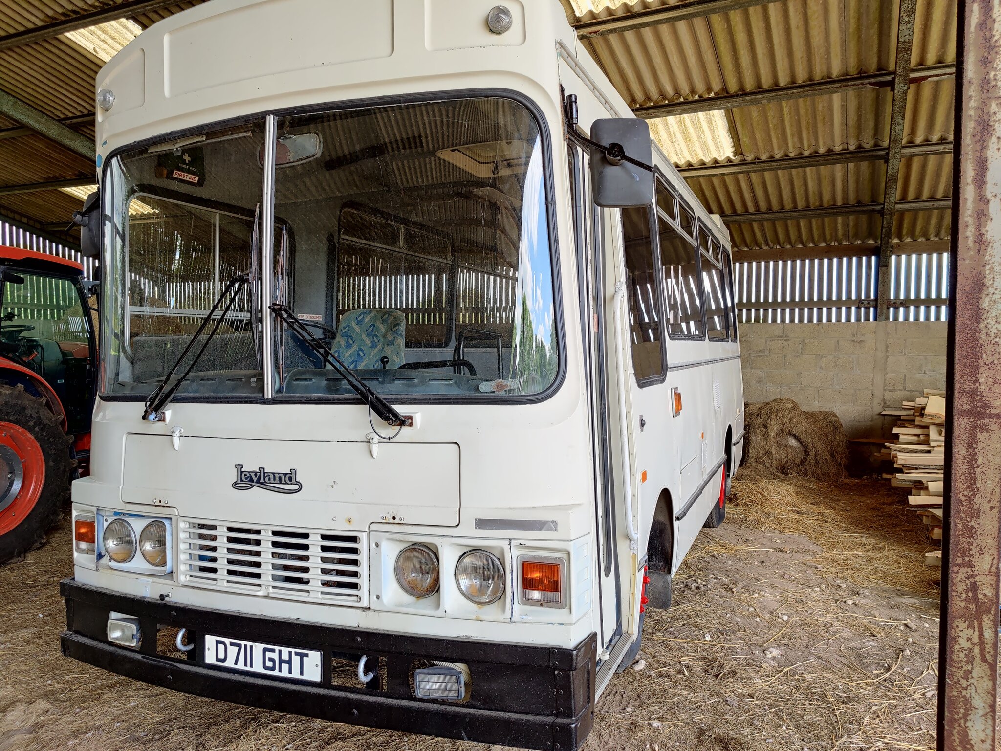

Quite right, very remise of me.
Her she is when she got to us.
A Wadham Stringer coach-built body and we think in service as disabled transport in Penzance.
She's a shorty at a little over 20' long and very conveniently under 7.5t 😀
Has the fabulous double rear doors associated with Wadham ambulances too.
Wow, she's beauty, I love self-builds on random chassis. You will have loads of fun on the build and later in use. Well jel. as the kids say.
PS. pretty jealous of your barn too....
