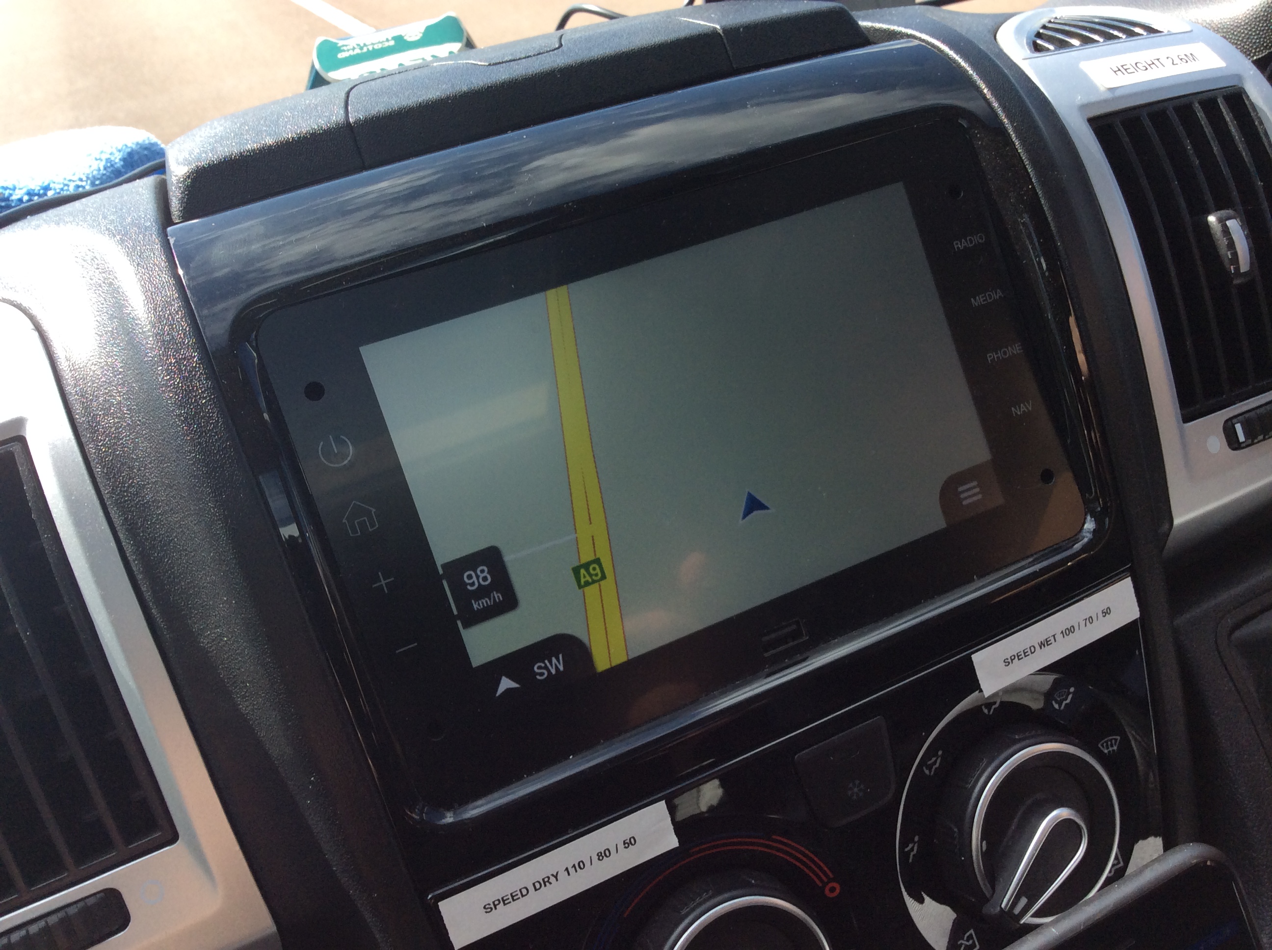

Hi all. I have an Adria Twin, 2021 model, and currently on route to France.
The standard sat nav keeps losing position, see pic. I’ve tried switch off and on, restore except for restore to factoy settings but can’t get it to stay on the road.
I actually want to use my phone on Apple car play but as soon as I connect my phone it seems to pick up location from the Fiat unit and loses its place as well.
Anyone else had this and worked out how to fix it?

That unit is dire. I have the same one!
Mine MY20 has 2018 maps and the update process does not work (supplier of unit has spent hours on it lol). I'm awaiting another OS version....
I use it for Android auto and TomTom and have no issues on location, neither does the van. I didn't think the apple/andoid used the GPS from the van but a quick check says it can. Learn something every day! It may be configurable in phone app?
Other than that, what version is the unit OS and Nav OS?
Nav system is 9.35.2.258804 update 11Jun21
Hardware V1.0.4
Software V1.0.4.9 CP AA DAB NAV
It’s always had this issue but got it to work last year, just can’t remember how.
I was successful in downloading an update which fixed the default to kph and updated maps but this is an ongoing issue.
Fortunately I do have my iPad and a GPS dongle so can switch to that if I can’t get the Fiat unit fixed.
This is a problem that can occur when the head unit has it’s own gps and sends erroneous gps data to the phone, rather than letting the phone use it’s own more accurate gps. My head unit does not have navigation or gps which allows the phone to do the job without interference. If you google the problem you may find a solution for your head unit but basically you need to disable the erroneous gps output from the head unit. This is one such link.
Edit. The alternative is to try and reset the head unit so that it sends the phone sensible gps data.

My nav version is same as yours. Just my maps are dated 2018 (have you checked your map version - thats within the nav). I'll see if the kph default is fixed. Does it still default to "van" speed limits rather than "car/motorhome" ?

My contact at the unit makers says:-
Because of your friend, let them exchange the Gps antenna.80% of the problem is the Gps antenna.
activecampers , my maps are June 21.
When I downloaded the update the maps all worked but one of the system updates didn’t, I wasn’t too bothered once I saw the kph was fixed.
I did suspect it would the the gps antenna as I know the DAB one is crap. Perhaps the start of a trip to France isn’t the best time to pull the head unit out for marital harmony!
If any one knows of a good antenna, let me know. Mine was doing the same until I added some adhesive foil underneath it and it was good for a while but has now started doing it again...😠

Did you ever sort this I’ve got the same stereo with the same issue
No, gave up trying.
Inbuilt sat nav maps now well out of date so must use as Apple car play. When you don’t need it it works perfectly, as soon as you need to depend on it your position drifts off the road so useless through complex junctions.
I now use an old iPad with CoPilot and a gps dongle. Screen is larger and higher so easier to see and I find CoPilot much better than Apple Maps or Google maps when in France. Don’t power iPad from stereo unit usb, I save that for my phone so I can stream radio to the stereo unit.
