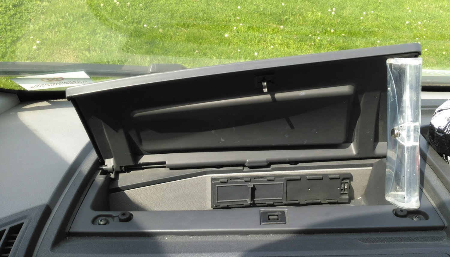

We've had our current van over two years and only just discovered a 'secret' air vent in the dash.
Opposite the passenger seat their is a shallow lift up "glovebox" on the dash..
When this it open there is a sliding hatch about 3" x 1" which when slid across to the right reveals a mesh.
Am I right in assuming that it is simply an air vent??

Is that not the secret cocaine smuggling compartment or is your design different to ours ?
It's the poor man's cool box that stays the temperature of the heating system, we rarely use it in fact I had forgotten about it :Eeek:

However, just because the grille may be present in the storage box, it doesn't necessarily follow that it is connected to the air distribution pipes behind the dashboard! The easy way to find out is to switch on the Aircon or heating and see if hot or cold air is blown through it :)
I have one in my Peugeot base Eldiss, euro 6 and it is connected to the fan blown air system, hot or cold

Bit of a thread bump here, but our 2019 has one of these without the slider. Is it ok to blank it off? On a few occasions it has cooked my phone, causing it to power down! Don’t see the benefit.
Yes because with the slider that is all it does, blanks it off from heating or cooling.

Just recently picked up my new van based on a Ducato and same issue. Installer had brought the USB cable to the head unit in through that and on the way home, my neatly packed away phone cut out due to being fried. I guess I just blank that off somehow. Seems weird they have removed a sliding vent door.
I ended up taping it over.

It is where I put my phone to keep it cool, it gets the benefit of the air con.
