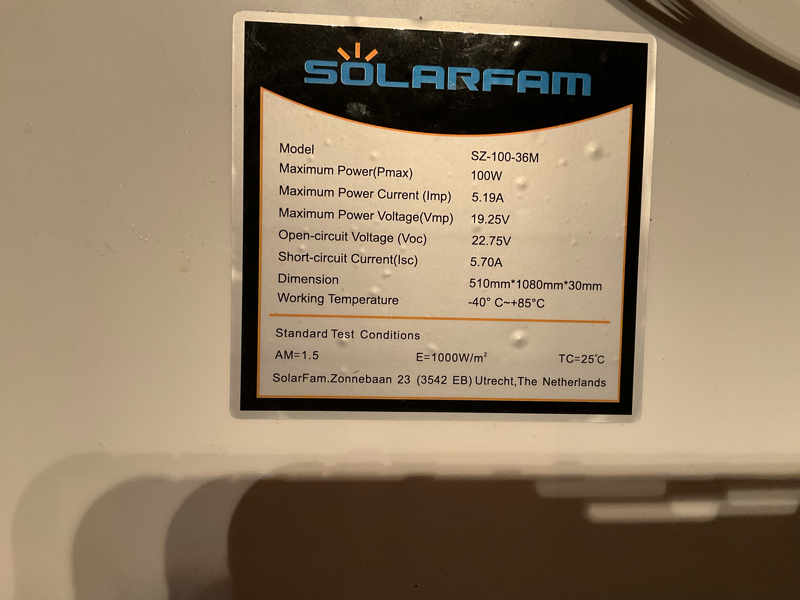

Is it better to join two solar panels of same voltage but differ in watts. Like a 200 watt and a 100 watt solar panel
in either series or connected parallel .
a question I have not found an answer for

In this particular case, your best choice is parallel. The amps will add up, and you will loose 0,25 volts from the higher one to match the lowest. Perfectly ok.
Thanks that’s how I saw it as well if the smaller panel had been 0.25 higher they would have matched in voltage.
hence higher amps same voltage.
