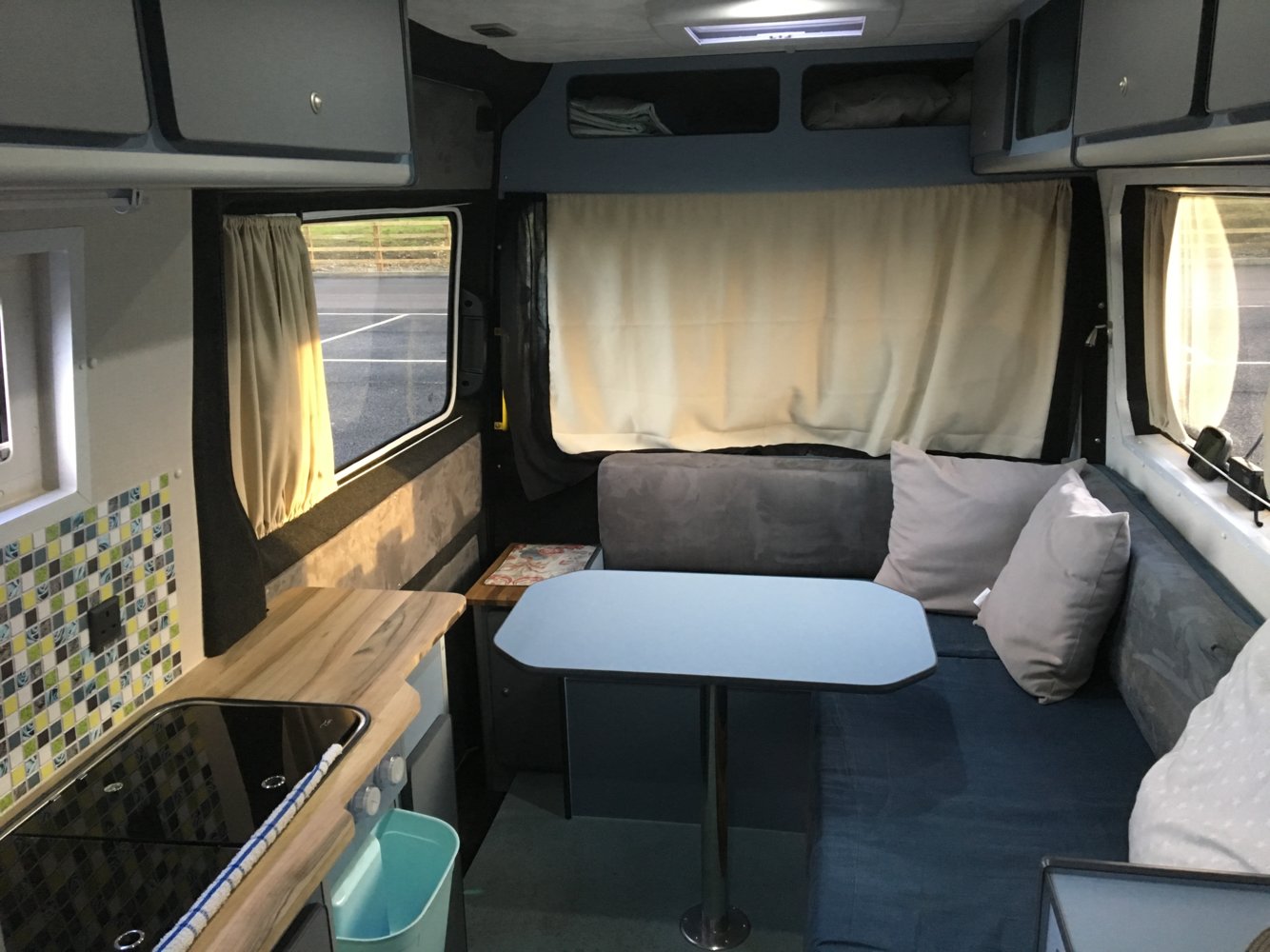

Ok, so this is what I did. Cut out a bit more metal than I had initially envisioned when I started this thread but I think it works well.
still need to sort trim and curtains but I’m happy with the result
I was thinking about having a doorway in mine, but that does look like a good idea. There would be enough room to climb over into the cab if you needed to get away. Will you have a curtain or a hatch made of wood or similar above the seating?
I'm going to install a heavy curtain. Seems like the best option. I think a hatch of sorts would just be a nuisance.
