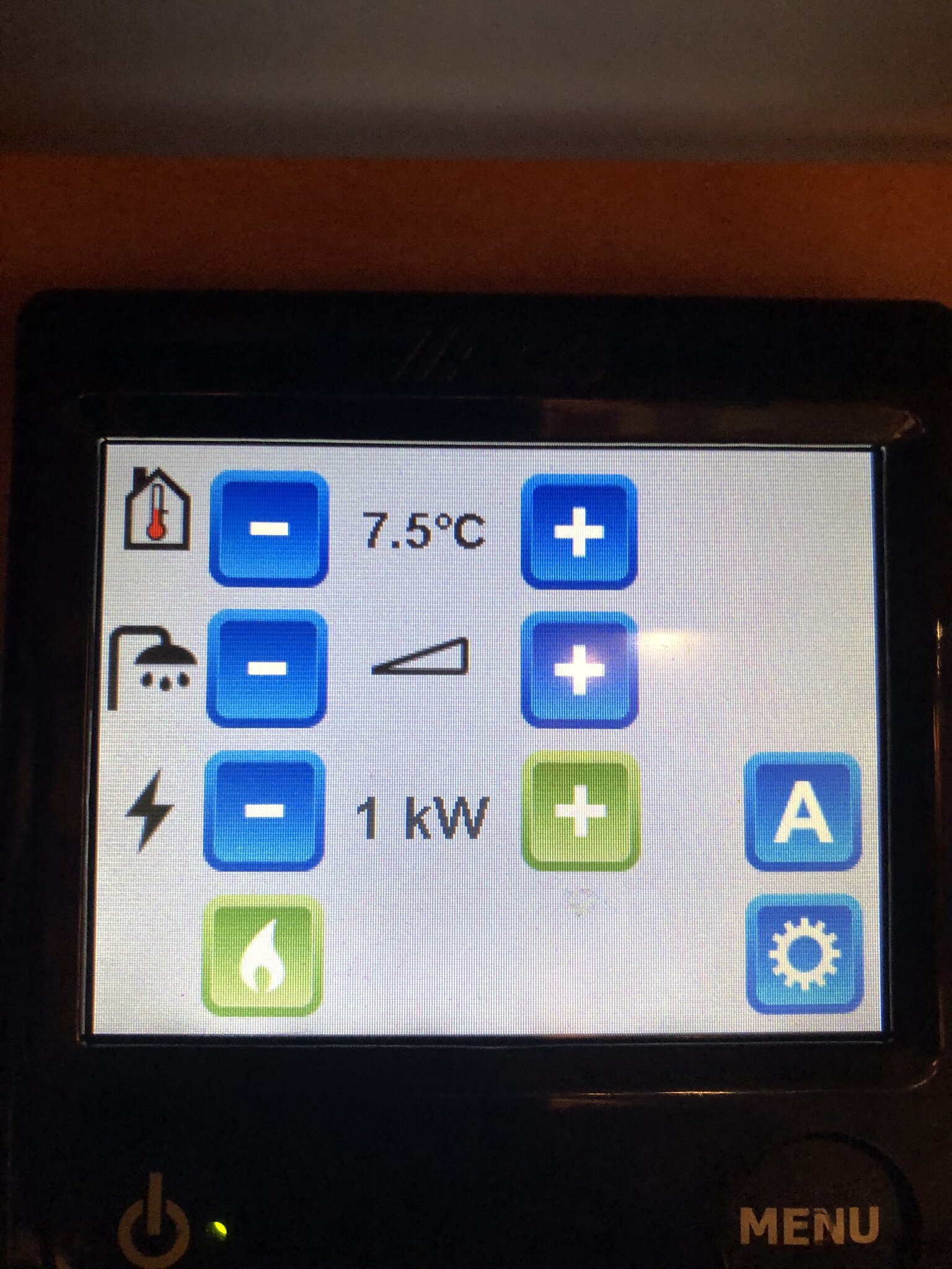

Well this hasn’t gone very well!
Right, press the cog (settings) lower right side.
Press the down arrow (centre) 3 times
You will see a box “Installed accessories” press this.
Press the centre arrow you will then see the pump options
I hope you get somewhere near with this description🤞👍

So pump running OK Mark? you say 230v setting is greyed out, do you mean pump on 230v ? if you don'r have a 230v pump it won't show as an option.
Yes pump now running, that explains the 230v then, the only other setting is constant or therm though.
OK but a puzzle why it wasn't running on gas setting when the panel said that it should be, "therm" is when the boiler runs hot and the pump switched on/off to control the room heat from the thermostat, "continuous" is as it suggests so the boiler has to reduce the temperature of the glycol heating fluid as the room warms up, the downside is that the domestic water cools as well so not good when the Mrs goes for a shower :LOL: or even worse? when you do :unsure:
Ok, perfect👍 didn’t realise there was another setting deeper in

Yes, perfect thank you, so do I need to do this when I’m not on hook up? Or should it pick up automatically?
Didn’t realise that the panel had those settings, can’t see anywhere in the manual for them.

I had this problem in Germany last Xmas BUT even on another electric bollard it wouldn’t work, so I went into the menu and put pump on 12v and it fired up straight away🤷‍♂️
It has worked on 240 since so I don’t know what the problem was really🤷‍♂️
When mine wasn’t working in Germany last year, the pump was showing running but it shut off pretty much straightaway, so I went into the temp settings and the glycol temp was well up, it just wasn’t getting away from the boiler, shutting it down instead. I then selected 12v and it fired the pump up straightaway🤷‍♂️

I think it “should” pick up automatically🤔🤷‍♂️
As this👍 never been into the settings so this must have been from the previous owner

We don't have the 240v as an option even ;) saves confusion I suppose.
