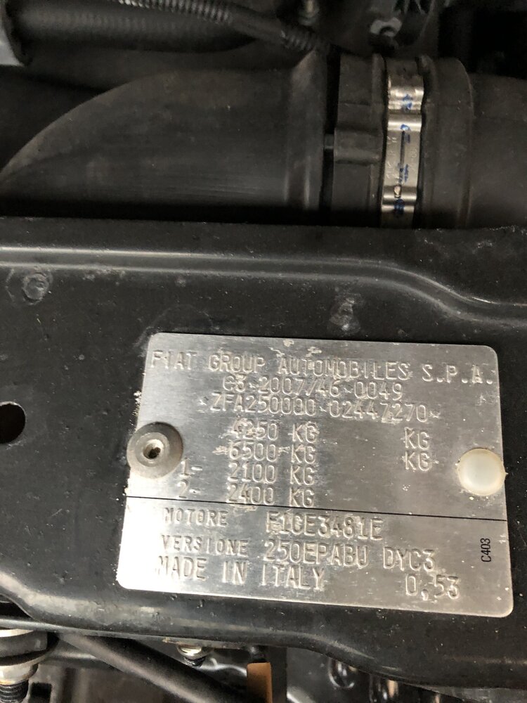

Sorry to hijack the thread, but does anyone know what’s involved to up plate a Fiat maxi chassis (NOT Alko) from 4250 to 4500kg I‘m on 118 tyres at present and NO air assist suspension?
Speak to a person / company who knows what they are talking about and what they are doing. A phone call to SV, with no obligation, costs nothing.
Unfortunately, I’m still waiting for JR to reply to my questions.🤷‍♂️
If you want 3850 with 2240 on the rear axle, you will need semi air and 225/70/15 tyres
