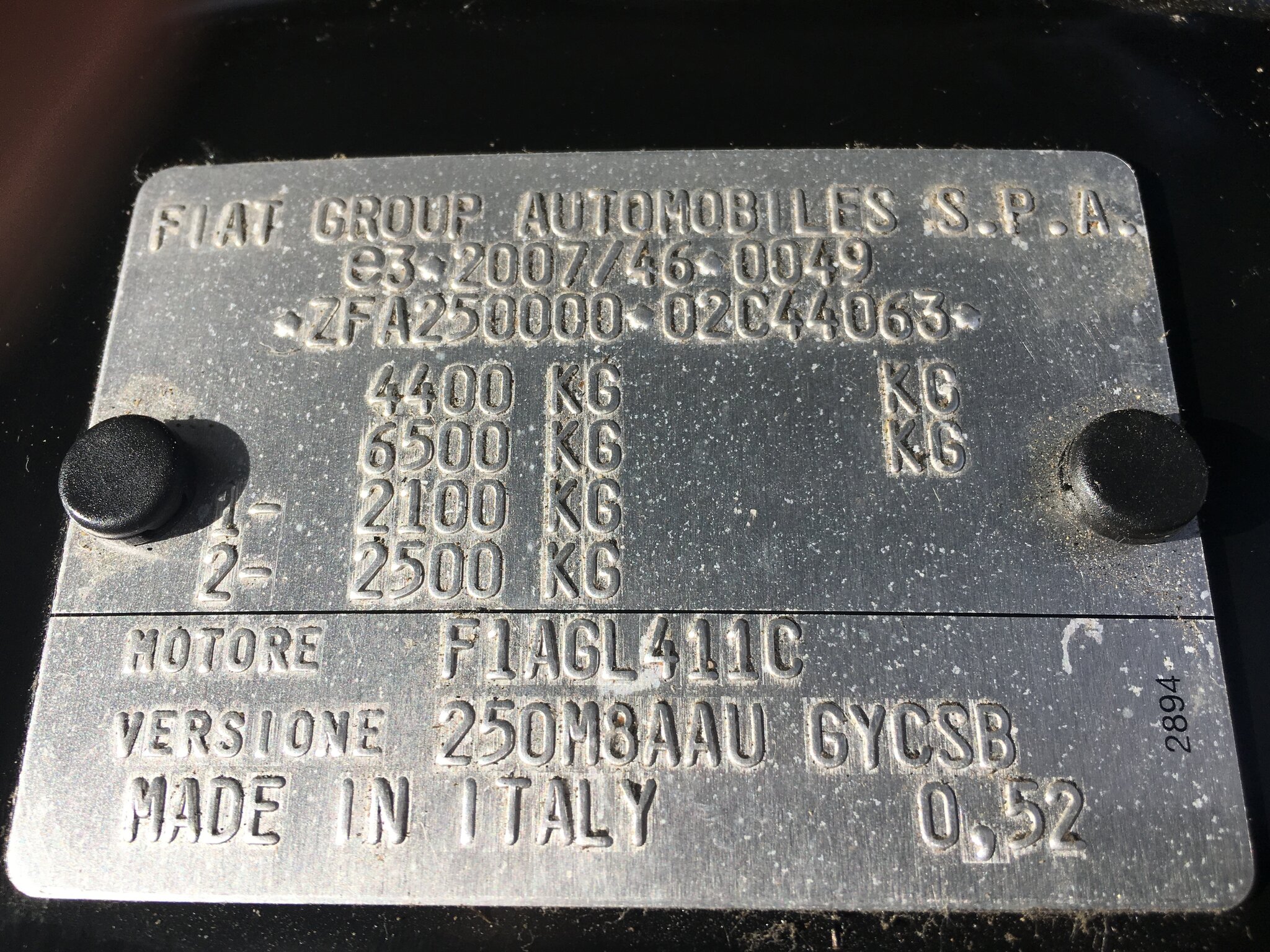

I took my Benimar 286, which we bought new in 2016 to be weighed for the first time yesterday. One 6kg calor light bottle, dishes, a little food and a few odd bits, but no water. It has a Fiamma sun awning factory fitted, an extra, which would have to be deducted off the original payload, which is listed as 370kg.
With myself on board and three quarters of a tank of diesel, it weighed in at 3182kg. The weight of my wife and another bottle of gas, now the heavier steel one, about 14kg will also have to be deducted off the payload.
My payload will now be reduced to about 240kg. So I cannot load up without knowing the weight of each item, which includes two electric bikes etc.

What were the individual axle weights? Its possible to stay within the overall weight max but overload the rear axle on some MHs, especially those with garages.

I think he is saying that a van advertised for six weighing 3500 kg gvw is not fit for purpose🤔 I think I would agree with that? However your particular van is obviously plated for higher gvw so is more practical😊
I think you are missing the point Mickey1 , I'm not saying that YOUR van is unsuitable. I AM saying that the Benimar 294 is ALSO sold with a Maximum allowable weight of 3500kg. It is STILL, at 3500kg, advertised to exactly the same buyer, even though it has a maximum payload of 260kg WHEN SOLD AS THE 3500kg VARIANT. You, with the higher payload, have a massive 1120kg of payload...which is fantastic for you. If someone does not have a C1 licence, which many do not, Benimar will still quite happily sell them your van in a 3500kg variation with a payload which makes it completely and utterly un-useable as the family van that it is advertised as. You can post screenshots of your 4400kg allowance all day long, it still doesn't change this basic fact that Benimar, as a brand, have paltry payload allowances across their ENTIRE range that can only be resolved by up-plating to a higher GVW that many do not have a licence to drive.
I totally agree with you, but even after I uploaded the plate you still said I have 260kg payload, anyway, besides Benimar, I think there are hell of a lot of vans out there that are unfit for purpose.
