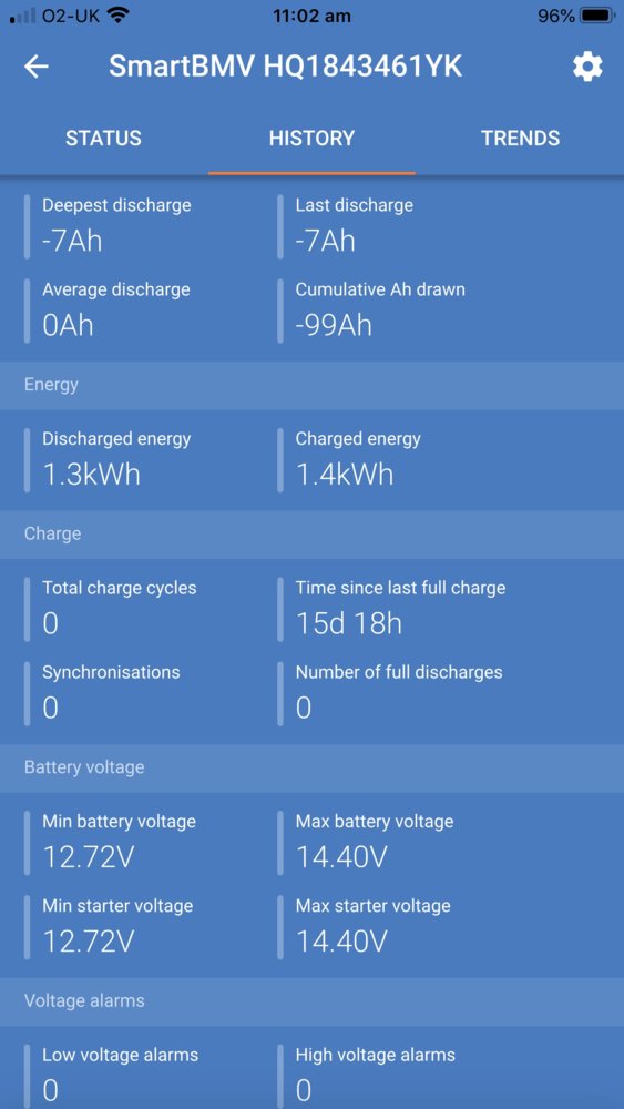

I now have a Bluetooth monitor so I can keep an eye on them, they have been ok since and voltage has been between 12.72 -14.40

Some screen shots from today....

I would take the jumper out, assuming nothing is attached to the load terminals. If you look at your screen shots it says the batteries haven't had a full charge for 15 days. If you take the jumper out it will use the Battery Life algorithm as described in para 1.4 of the manual. This it claims should ensure the batteries get a full charge at least once a week. It says it does this by altering the voltage the load is disconnected. Now I'm a bit unclear what this means if there is no load to disconnect but I suspect it may not matter and it will carry on trying to give the batteries a full charge anyway.

I think it says it’s not had a full charge for 15 days because it’s just been sat on the drive and no loads have occurred to drain the batteries..?
indecently, the starter battery reading is the second leisure battery in my two battery set-up...
