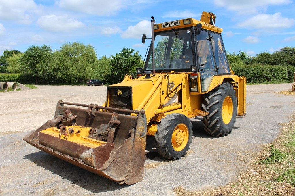

A common transmission noise on early JCB 3cx machines was partially cured by drilling small holes in the prop tube and filling with builders expanding foam. The noise was so bad the driver had to wear ear defenders in the cab. I know your van is not an excavator but the machine had exactly your type of set up. Engine, torque converter, transmission and prop.
