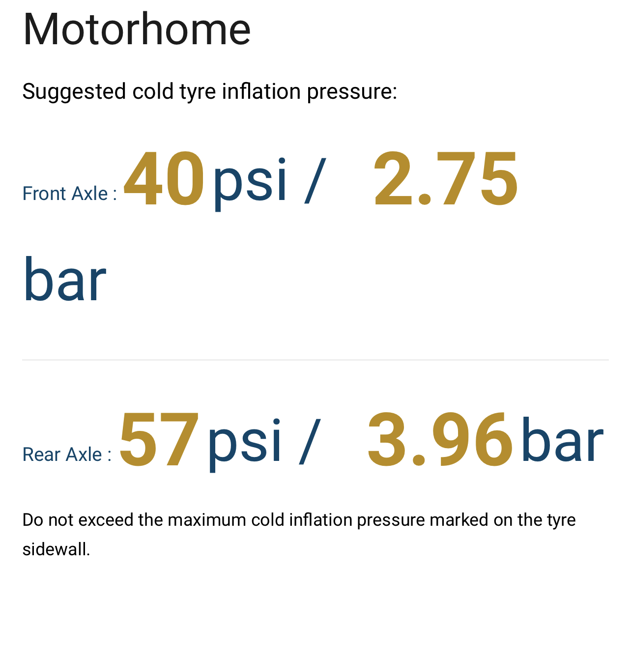

Update
I finally managed to get the van weighed.
Front axle 1411kgs
Rear axle 1690kgs
Total weight 3101kgs
V5 says gross weight 3400kgs
These weights are with the van fully loaded for a trip.
Tyres are 215/70 R15 C109/107.
Door pillar says the tyres should be 79.5psi and the tyre manufacturers site says 80psi.
These pressures seem high to me ?

Go to
And put the data in - it will tell you the best pressures. It is likely the door pillar numbers are for the base vehicle, not the Motorhome. The 80 psi is an American thing I think they have a max pressure rating printed on tyre over there.

Go to
That link opens Tyresafe but it won't let me put any information in ?

Front are Continental Matador Maxilla and rears are Rotalla Transporter.
Worked for me:

When I bought the van, Swift Suntor 590RL, I was told they always ran 65psi all round and they'd just checked the pressures.
I've been using it assuming that those were the pressures.
However I checked them recently and the fronts were 72 and 70psi and the rears were 52 and 50psi.
I have dropped the fronts to 65psi and the rears upped to 70psi.
This has improved the handling.
The rear doesn't sway as much and the front is not so hard over potholes, speed bumps etc.
I was thinking maybe reduce the rears to 65psi and the fronts to 55-60psi ?
